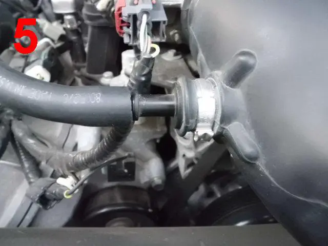

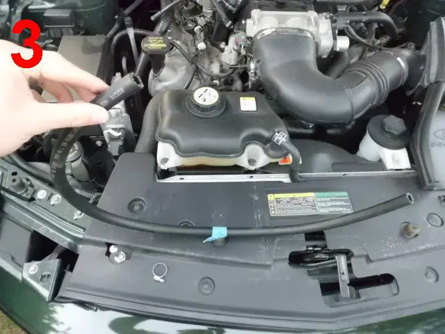

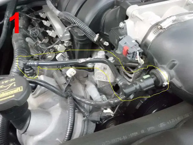

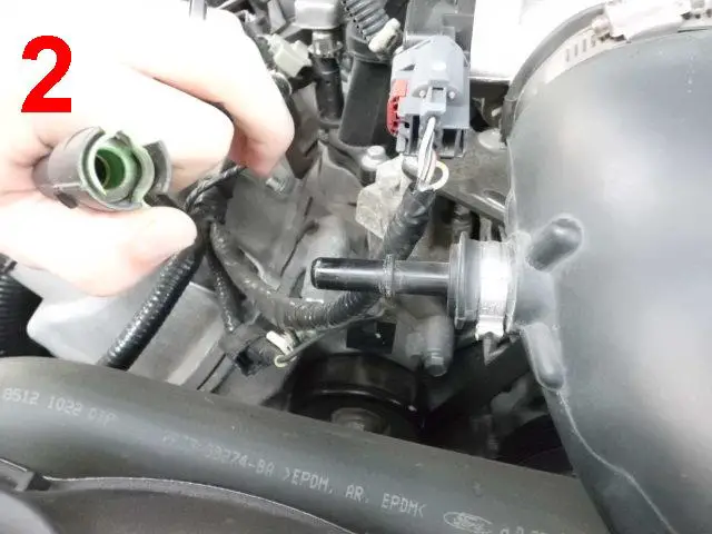

Here's what I'm getting at, explained in pictures. You can do it yourself for under $10. It's easy!
1. Here is the factory hose I am using as an example. The one pictured is a PCV hose, but all these clip on hoses work pretty much the same, they are just shaped differently. Both ends have the clip on style connection.
2. Disconnect the ends by pushing the clip release tang and pulling on the connector. In the picture my thumb is pushing the clip's release tang, which sticks out. Notice the fitting it was connected to is just a normal nipple style fitting, with a ridge on it that the clip holds on to so that it won't slide off.
3. Pictured is a chunk of rubber tubing, available at any auto parts store for cheap. They have this stuff on rolls and sell it by the foot, usually for under $2. There are different varieties for the different fluids or vapors the hose will be carrying. Just ask for fuel vapor hose, in your case. Also, the inner diameter of this tubing varies. You want to get the right size that is a snug slip-on fit onto the fitting (nipple). If you bring your factory hose, they can probably match it up. It does not have to be perfect, just close enough.

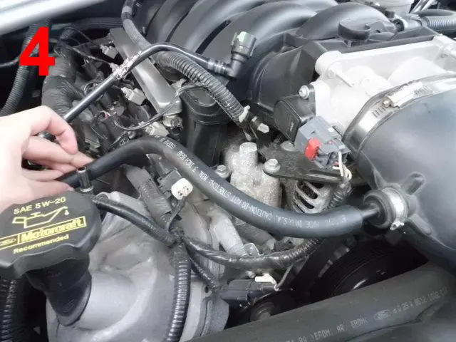

4. Estimate the length of hose you will need. A little extra is better than cutting it too short. You can cut the rubber hose with anything good and sharp. Scissors, serrated kitchen knife, razor blade (carefully), whatever.
5. The new hose just slips onto the fitting. It may be a snug fit requiring you to lubricate the fitting with a little water or spit - that's good. If it fits on too loosely, it could leak. You can slide it on past the ridge if you want, for extra hold strength, but in my example, the hose was too tight to go over the ridge. No big deal as long as you have the fitting inserted as far as you are able into the hose.

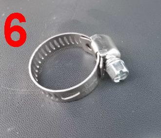

6. If you want to add an extra measure of protection to keep the hose from slipping off, you can buy a hose clamp. They come in different sizes to fit different diameters of hose. See the next picture...

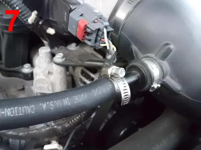

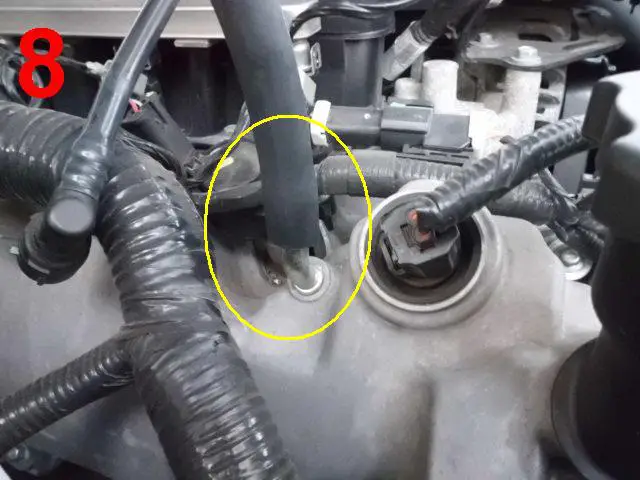

7. The hose clamp simply slides over the hose to where you want it, and then tighten it down. Don't tighten it too much because it might break the fitting. Just tighten it enough that it squishes into the rubber hose a tiny bit.
8. On the other end, you do the same thing. Just slip the rubber hose on. Add a hose clamp if you want.
9. You are done! In the example picture I used a much longer piece of hose than was necessary. But it would work fine. You won't hurt anything by making your hose a little too long.
Any questions? This is something you could easily do yourself. Took me less than 5 minutes.

I can't tell you how much I appreciate the detailed instructions and the pictures!! My sister has a friend who's husband knows a bit about car repairs. This will no doubt be very helpful to him!!
When the dealer service tech was showing me where my hose issues are, they were unfortunately buried about 6-8 inches below the battery. I could barely see the 'valve?' with the 2 hoses coming off. They disappeared down below something. I'm not even sure if you have to approach from the top or bottom to get to it. I WISH it was as easy as your photos!! Then maybe I COULD do it myself!
Anyway... VERY GRATEFUL for your help with this!! I'll get this post to him tomorrow and hopefully we can 'get er dun'!
