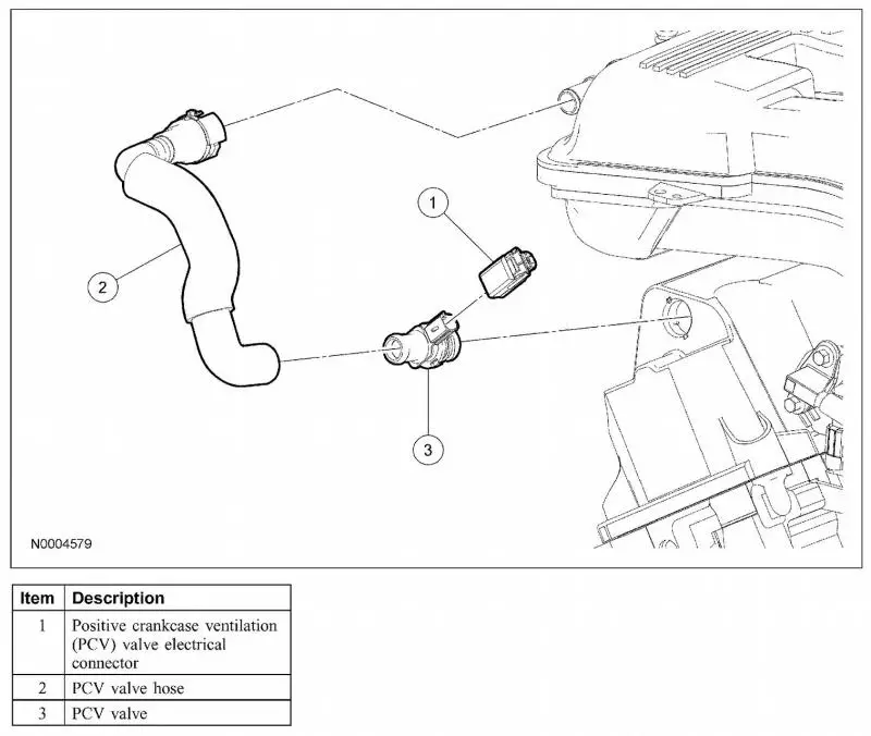

Need info on how to change the PCV valve on a 06 Ford EXPLORER, 4.0 L engine,with pics if possable, lots of instructions on the 05 and down but cant locate info on the 06. Thanks

From www.brakeandfrontend.com. The article is located here: http://www.brakeandfrontend.com/issue/article.aspx?contentid=38742
Both, the 4.0L and the 4.6L use a PCM-controlled heated PCV valve. The PCV valve on the 4.0L SOHC engine is located in the back of the left valve cover, mounted horizontally, and is well hidden from view as it is sandwiched between the valve cover and the firewall.

It looks to be integrated into the left valve cover just behind the oil filler spout.
Removal and Installation 1. Disconnect the PCV valve electrical connector.
2. Disconnect the PCV valve hose.
3. NOTE: If the PCV valve is removed from the valve cover, a new PCV valve must be installed. Rotate the PCV valve counterclockwise and remove it from the valve cover.
4. To install, reverse the removal procedure
Hopefully this will help you.
