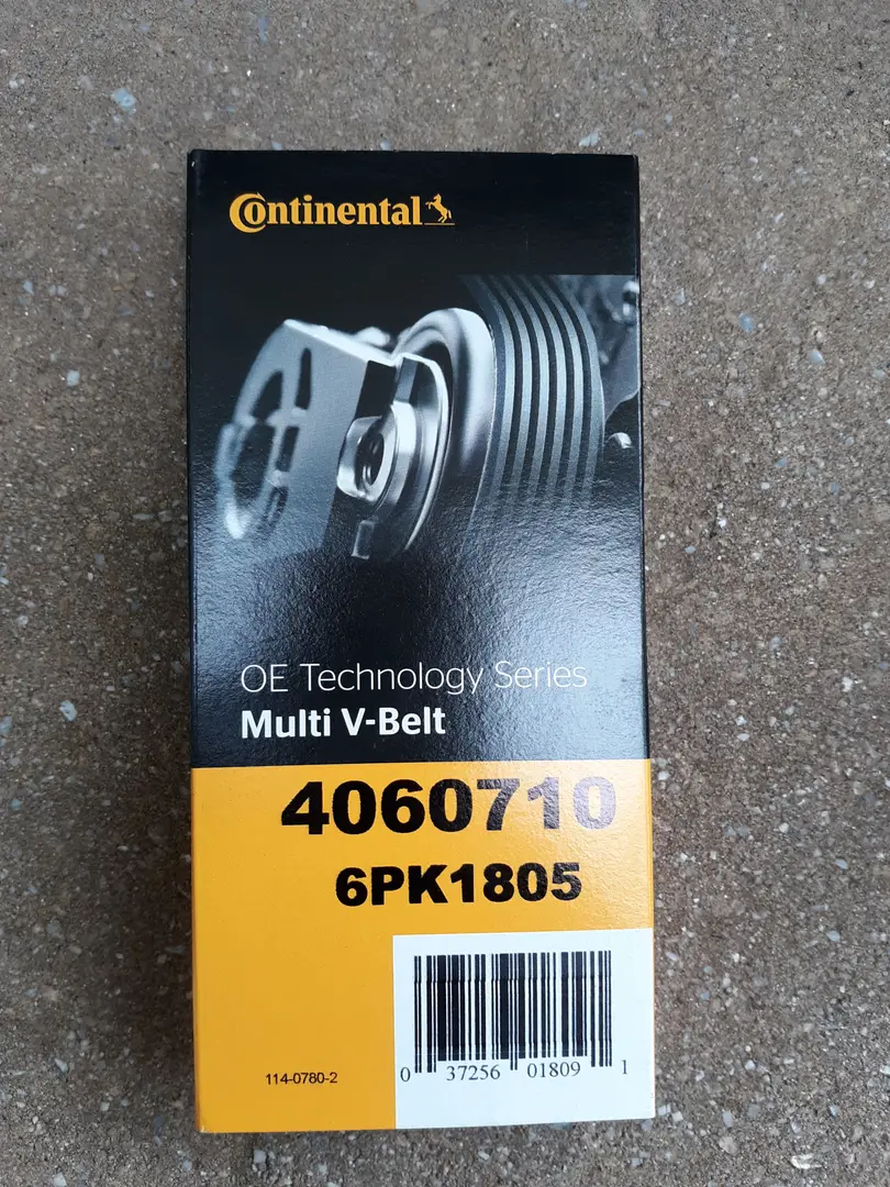

2001 Ex Sport, 4.0 - Clutch refuses to grab when engaged only grinds against the pulley and when not engaged hits the pulley constantly makings a horrid noise. It's cooler right now in Southern Florida so A/C or heater is not needed. :cool:
Truck starts up easier and runs significantly smoother. Part 5060710 worked like an absolute charm!

Bypass belt is a Duralast # 750K6. It is a 75" belt and works perfectly
