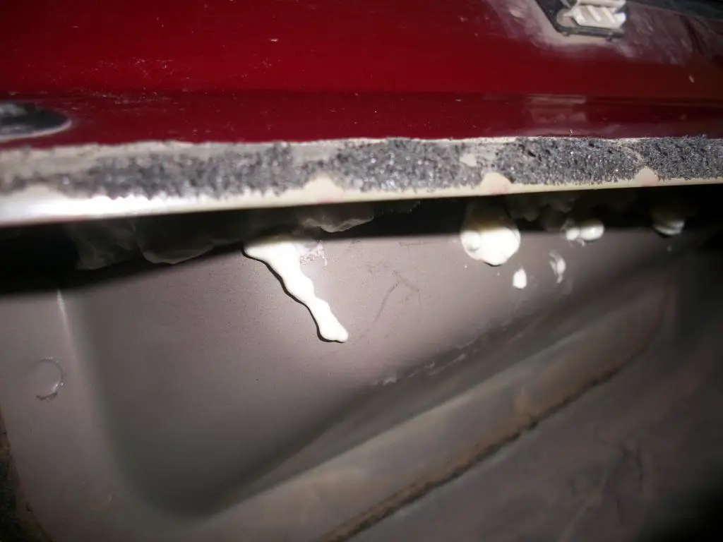

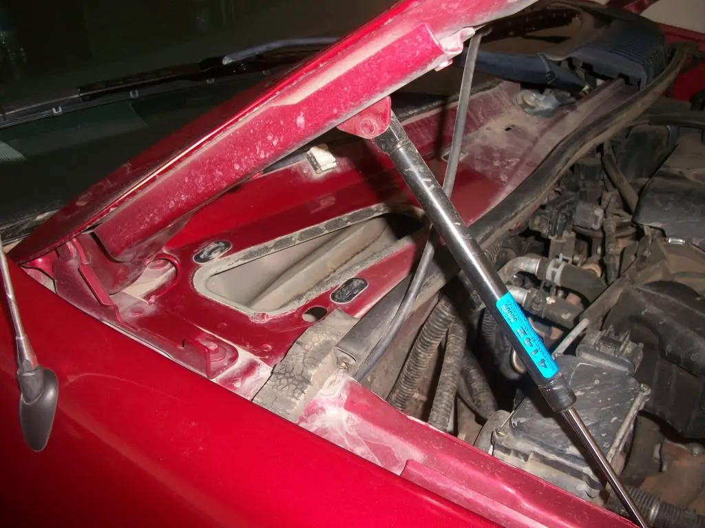

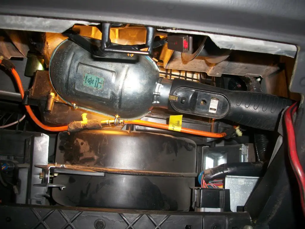

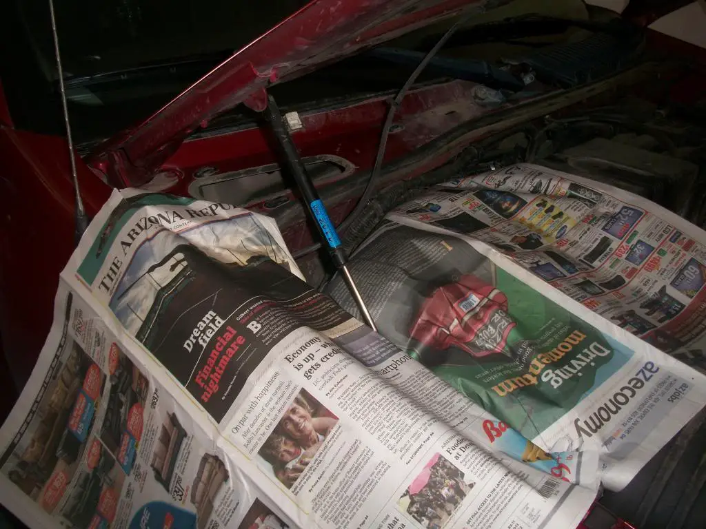

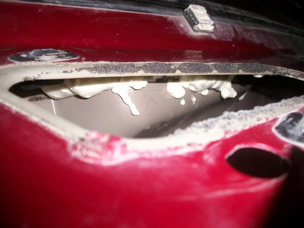

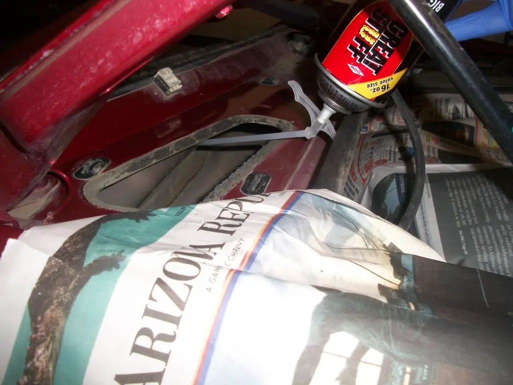

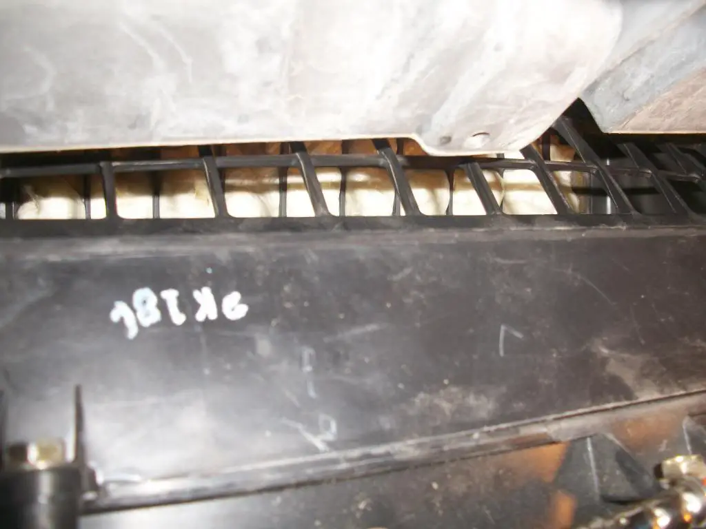

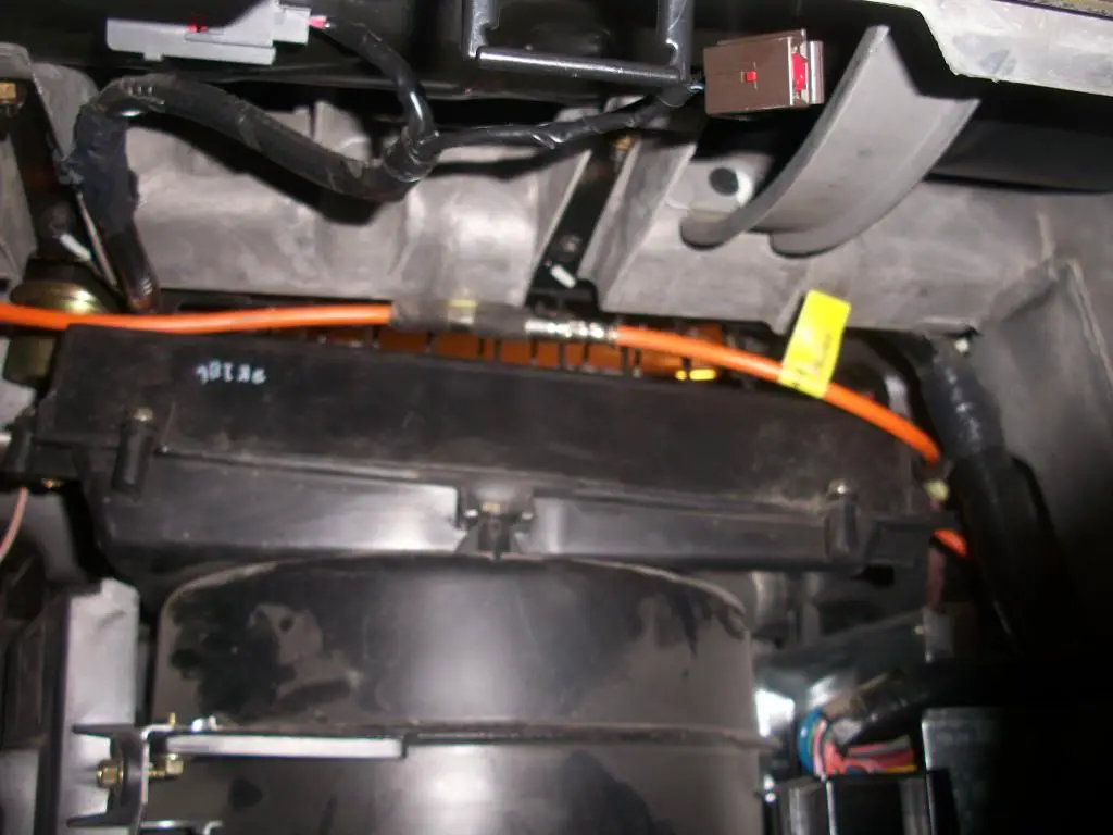

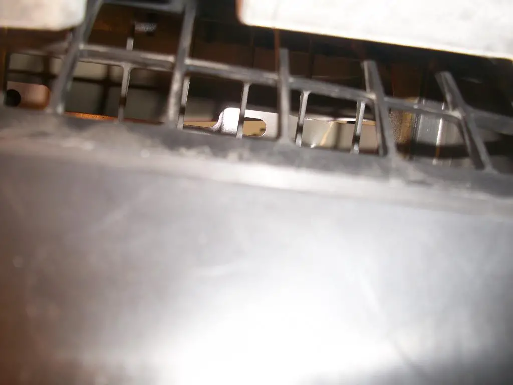

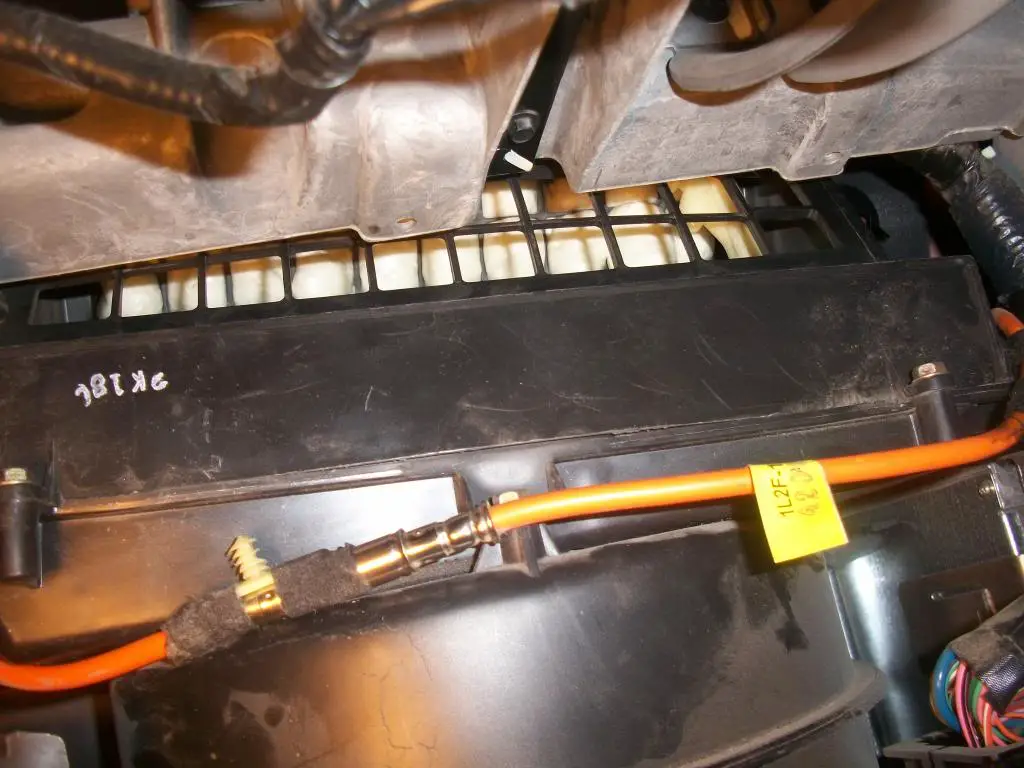

Okay, following in 03AZExploder's footsteps I documented how to deal with the air inlet. This is assuming you have already read the following thread:
Cold air in glove box -OR- No air flow from vents on Max AC - Here's a workaround
This is also assuming you no longer want to have any kind of "fresh air" option through the vents as it completely blocks the air inlet. Lastly, do your research on "Great Stuff." This is a one time use only product and from what I have read it can get very messy. I took extra procaution when using it and just threw it away when the job was done. That being said, I ended up going with the "Big Gap Filler" type of "Great Stuff" and it worked very well to expand quickly, fill the air inlet and leave no chemical odors.
Air Inlet
Air Inlet Close Up
Air Inlet - Inside Glove Box with orange cable in the way
Air Inlet - Inside Glove Box Close Up
Prepping the Air Inlet
Applying "Great Stuff - Big Gap Filler" from far right to left in the trough
Shine a light through from the Glove Box
Fill Air Inlet trough until no light shines through
Air Inlet with "Great Stuff" - Inside Glove Box
Air Inlet with "Great Stuff" - Inside Glove Box - Close Up
Air Inlet with "Great Stuff" After 24hrs
Air Inlet with "Great Stuff" - Inside Glove Box after 24hrs
Air Inlet with "Great Stuff" - Inside Glove Box after 24hrs - Close Up
