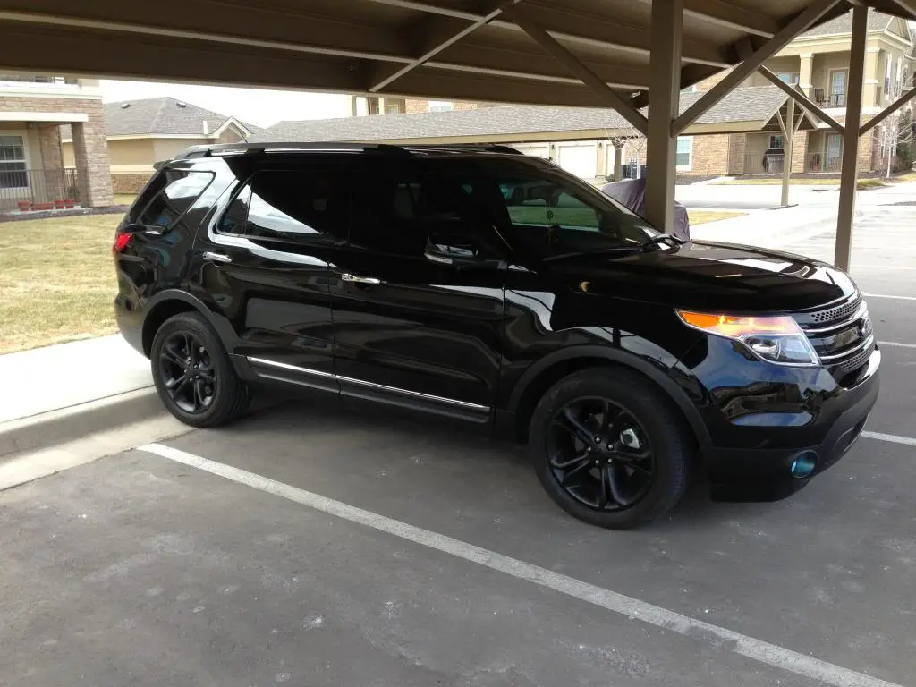

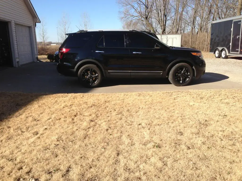

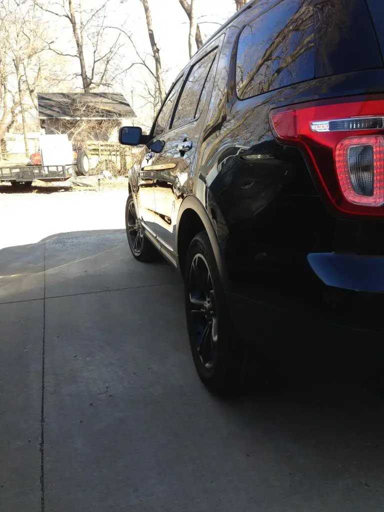

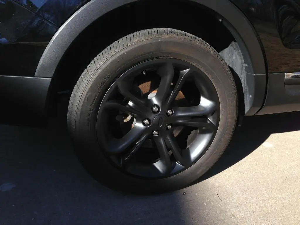

I decided to plasti dip the stock rims just to see how they looked. Must say, they came out better than expected. Put 6 coats per wheel just to make sure it was on there good. While I was waiting for the wheels to dry, I got bored and plasti dipped the back lettering as well as the chrome piece across the rear tailgate.

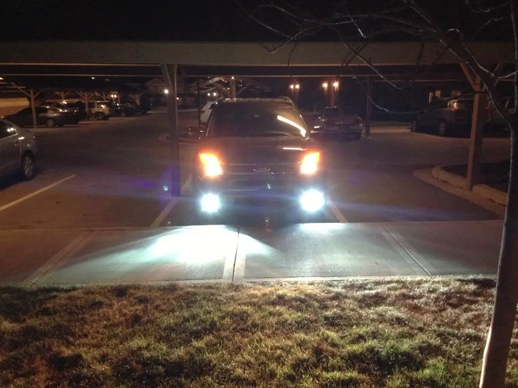

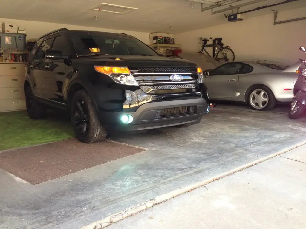

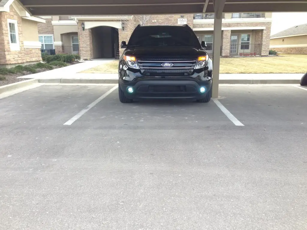

I also installed DDM Tuning 6000K HID fogs as well. A huge difference. My HID headlights will be in tomorrow so will post pics of them when installed.
HID fogs: and yes in the night time pic my low beams are on lol.
Nice!
I'm torn on the rims, every time I see them plasti dipped, they look so small to me.

Yea I understand. If you get bored, you could always do one wheel and if you don't like it, you can always peel it off :)

I'm curious what is the process to accomplish this? Do you have to sand the wheels down and how does it get applied. Is this the same stuff you can dip your tools in and how well does it hold up. I have trailer wheels that I might do.
Thanks
From what I understand after looking into it, the only prep is a little soapy water and maybe some rubbing alcohol.
The whole idea of the stuff is to protect what's underneath it and keep its original condition, so sanding would defeat the purpose.

There's not sanding required. I just took a cloth and some rubbing alcohol and wiped them down really well after i washed the whole vehicle. You don't even need to take the wheels off. Some people just mask off the calipers/brakes and spray it. I took them off because my banana hands couldn't fit so well behind the wheels and it was an easier process just to take them off.

Yea I used the same principle by placing notecards in between the tire and wheel. Very simple and effective.
