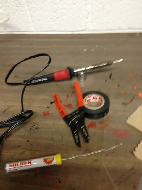

Here are the tools I used to convert mine.
I also found my pocket knife very useful too.

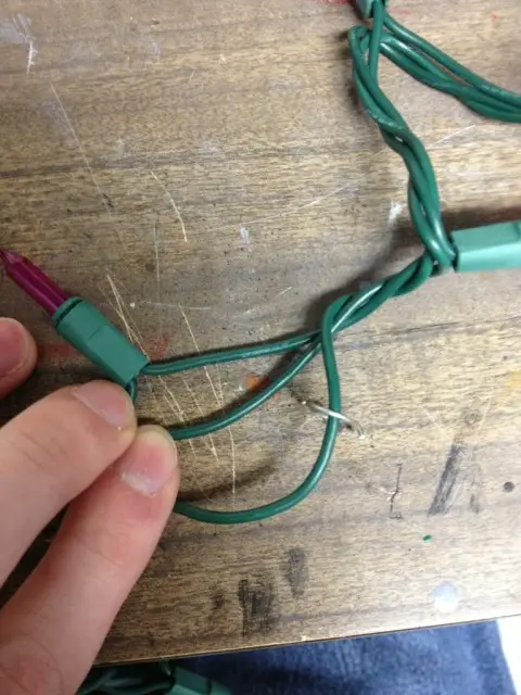

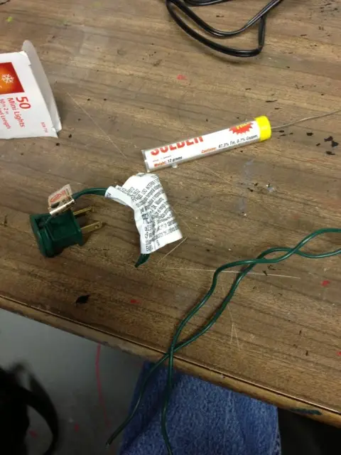

First thing to do is cut off the plug that goes into the wall. That will keep you from plugging the lights in and overpowering them.
Next thing I do is slip an object over the loose wire so that way I can easily keep track of which wire is which. For this one I use a piece of solder formed into a circle so I could just cut it at the end. I've also used a small key ring before too. Make sure to place it on the wire that isn't tied into the first bulb.

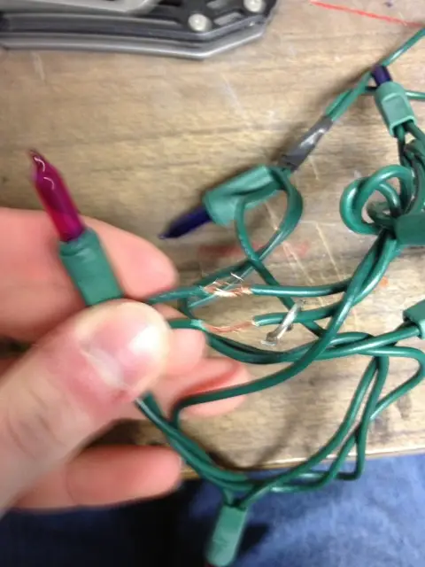

Now you're going to slide the ring through the wires and count the bulbs as you go. Once you pass the 5th bulb unravel the wires enough so you can identify the wires.

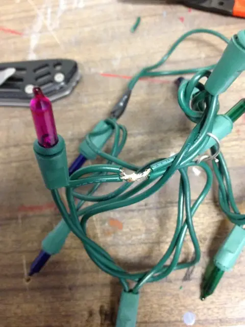

Now take the wire between the 5th and 6th bulb and the wire that has the ring on it and remove about a half inch of insulation from each wire.(I found this easiest by using the wire strippers and clamp down in one spot then move a 1/2" and repeat then I used the serrated portion of my knife to cut the insulation off. Bad explanation I know but it's the best I can explain.)
Now take the bare wires and twist them together and solder them.
Now wrap the splice with electrical tape. Then wrap all 3 wire to help keep them together.(Tip:cut your piece of tape 2x longer than you think you need and wrap the splice then add the third wire and continue wrapping. Saves time and tape.)

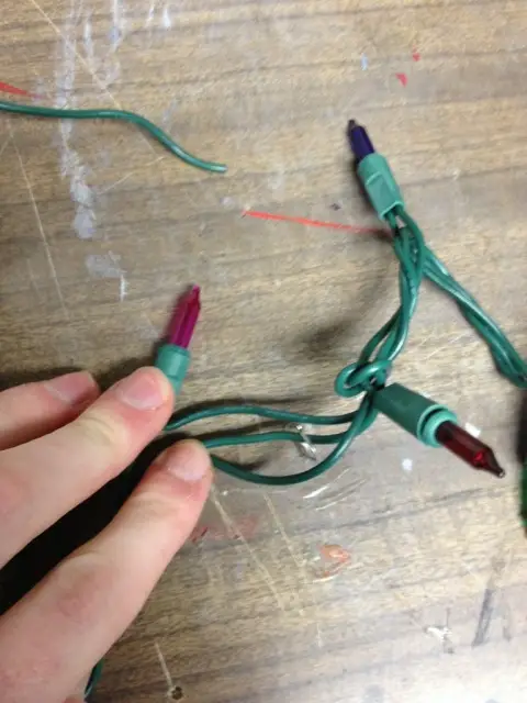

Now move the ring down 5 more bulbs.
And splice the wire between the 10th and 11th bulb and the wire WITHOUT the ring.
Now just do this 8 more times going 5 bulbs each time and remembering to alternate between the wires.

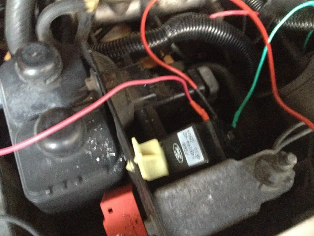

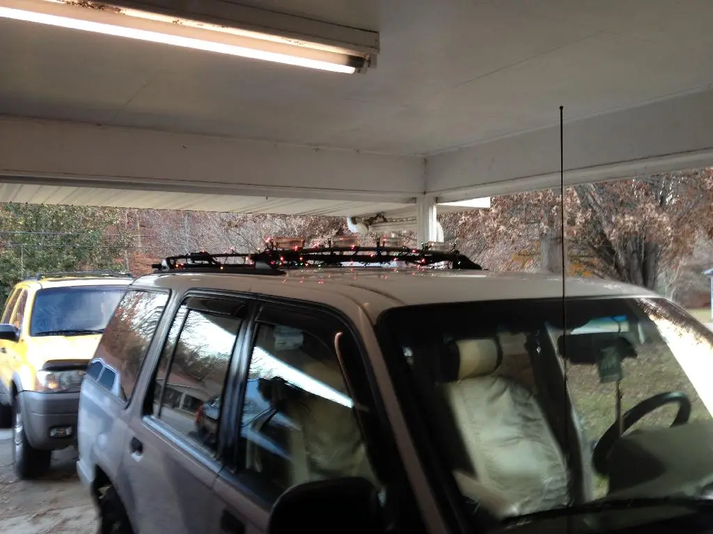

That's pretty much it just put them on the car and wire them up.
Oh and a note on the first set I made the first 5 bulbs wouldn't light up. I changed the pattern on the set I showed above but I keep forgetting to test them. If I find any problems I'll post up and let ya'll know.
