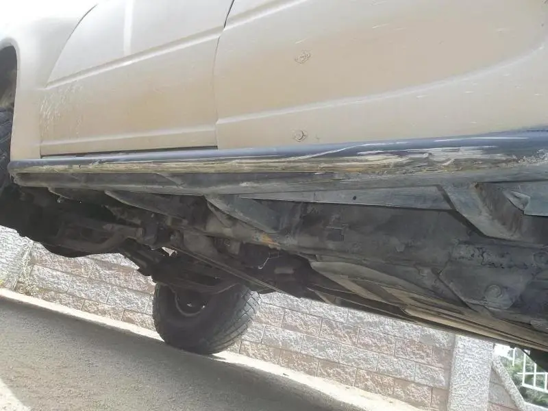

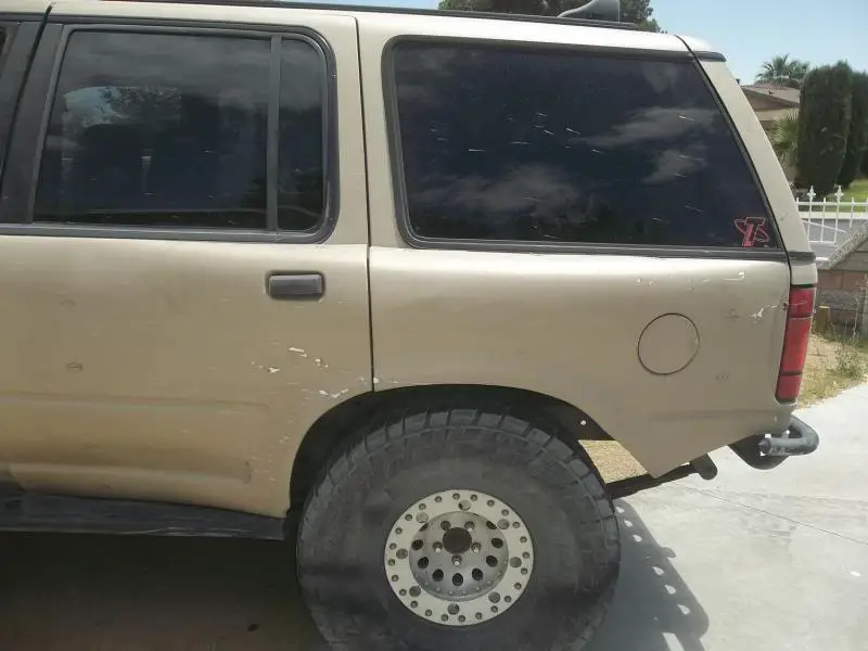

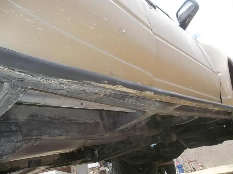

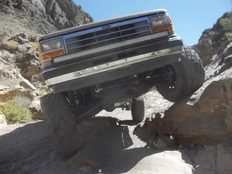

aftermath...
My bumper and sliders were somewhat freshly painted before yesterday... Or at least all the previous scratches and scars were covered with paint when I left the house yesterday morning. This is all from yesterday's fun... I believe they've paid for themself many times over already...

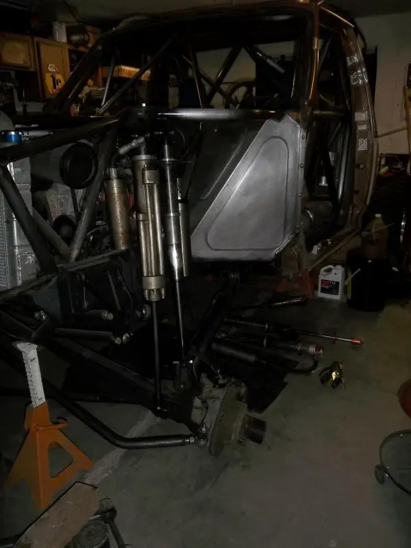

Started cycling the front end of my current project though. I'm going to have to make some changes to the coilover mounting points but with a few reworks it looks like I'm going to end up roughly in the 20-22" travel range up front. YIKES!!!

Looks like final numbers on the new ride are 21" front travel and 29" rear. LOL Should do...

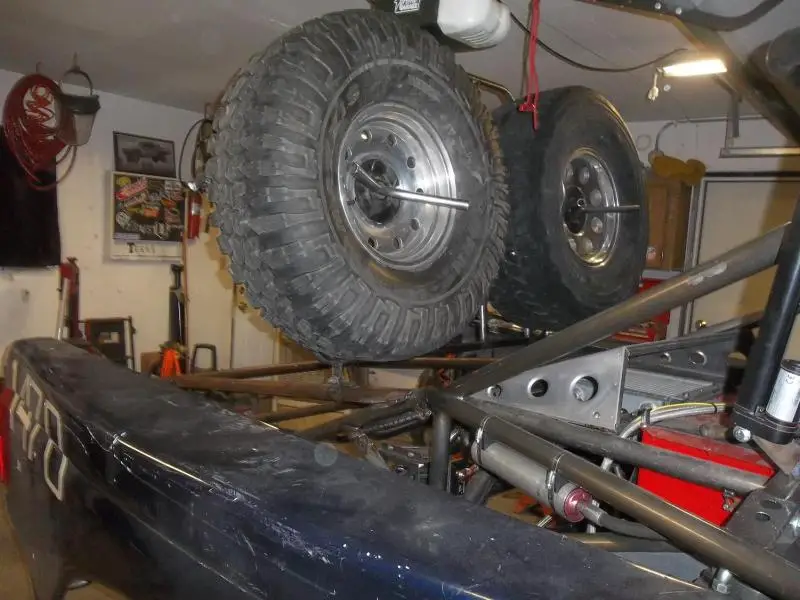

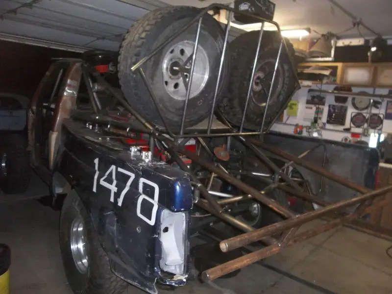

Couple people had some interest in this 2wd F150 prerunner I'm building... Waiting on parts is killing me. I'm on my 4th week of "next week" promises for the engine harness so I can start it up. Once that happens, assuming all works fine it'll go for exhaust and then I'm just waiting on a few front shock parts to have it in the dirt. Still will be naked with no front clip but that's the goal...
It saw sunlight for the first time in ages this weekend though and got pushed out of the garage for a major cleanup of the garage. It was getting really really really bad in there!
It's pretty wide!
Got air brakes? LOL
Actually, that's for access to a long term project of building a storage space underneath the spares.
Visualize this space all paneled in, it will make for a great little storage area on a single cab truck...

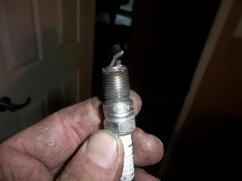

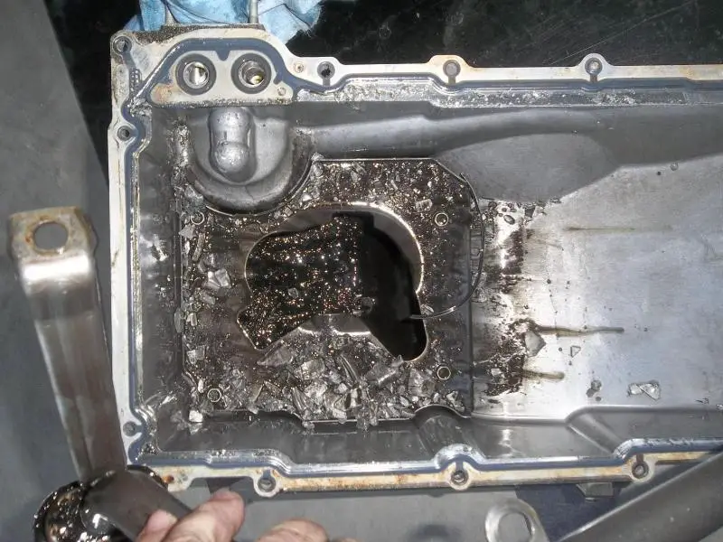

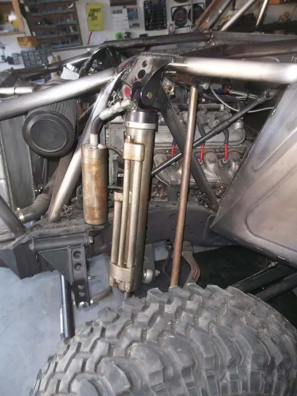

So, I got it fired up two weekends ago. Had to take it to the exhaust shop, then it needed about 2-3 evenings worth of finish up and double checking and I would've been ready for it's first testing session. It went thru one heat cycle just fine. Motor had about 10-15 minutes of run time on it... Then...
2 broken rods, 1 shattered piston and another piston still stuck up in the cylinder. Not sure wtf happened other then it went boom. Hoping to have it pulled out this weekend and on the hunt for a replacement.
...What's the back story on the motor?
..New build, came with truck or?
...that's some crazy carnage..:eek:
Came with the truck but I've got no reason to doubt the story and everything I've seen has physically backed it up. The person I bought the project from was a dirt bike riding friend of mine, no reason to think he'd be lieing to me... The motor is about 6-7 years old but has never been fired. It was a factory direct GM LQ9 6.0L which is basically an iron block LS2. It was slapped in the truck but never plumbed or wired and therefore never fired. It didn't look new externally cause of 6-7 years of machine shop dust building up on it but everything I ever saw internally looks brand new. I filled with with redline break in oil. I then built a pressurized setup and primed the block with the same oil. I literally primed it till the engine cooler at the back of the truck was full, filter was full and pulled the valve covers and primed it till oil was coming out the top of the pushrods/heads. I cranked it over with no ignition/fuel before first fire and all seemed well. The kicker, no exhaust, I had a manifold to about 10" of pipe on each side so SUPER LOUD!!! Fired it the very first time. It built oil pressure on the gauge in less then 10 seconds. I ran it for about 30 seconds and then shut it off. Did my happy dance and went back to work buttoning up the wiring and everything. Later that afternoon I fired it again, this time let it run for about 10 minutes. Everything slowly came up to temp, monitoring gauges, checking for leaks, physically feeling the rad hoses and radiator for when the t-stat opened, everything was good. LOUD exhaust though so it could've been knocking or clanking and I just couldn't hear it over the exhaust. Next day I fire it up, drive to the end of the street and back to turn it around and load it on the trailer. Next day I tow it to the exhaust shop, fire it up to pull it off the trailer, instantly think I'm hearing something clanking, few seconds to process what I think I'm hearing, go to shut it off and it locks up. Never rotated again... What you see above is what I got now...
I'm pointing at the two broken rods here but in general... Notice how BRAND NEW everything looks in these pictures I've posted... Again, no reason to doubt that it wasn't a factory direct brand new crate motor as I was told.
