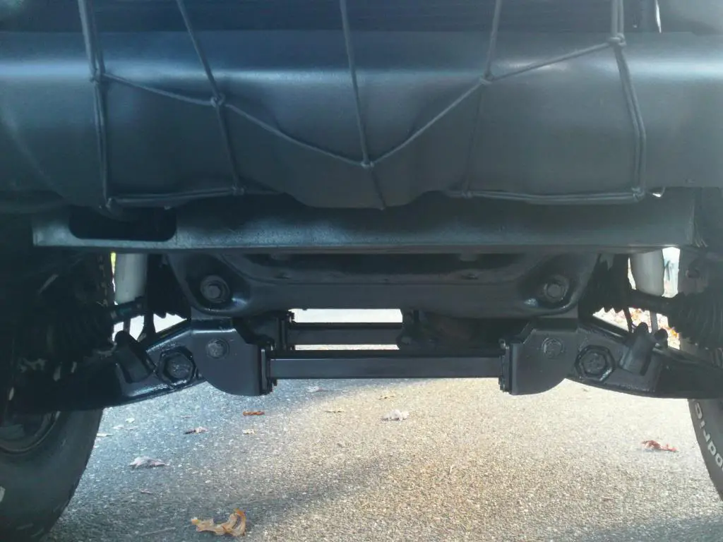

the front is ALL bolt on......I had to drill 2 holes in the lower control
arms for the limiting straps, other than that, that's it for the front.
for the rear I did SOA, so there is a little welding and some cutting.
and some creativeness. if that's what you plan to do, or if your going
for the 4in lift springs. then ALL bolt on.

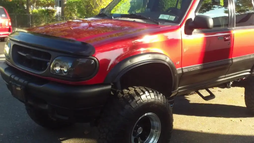

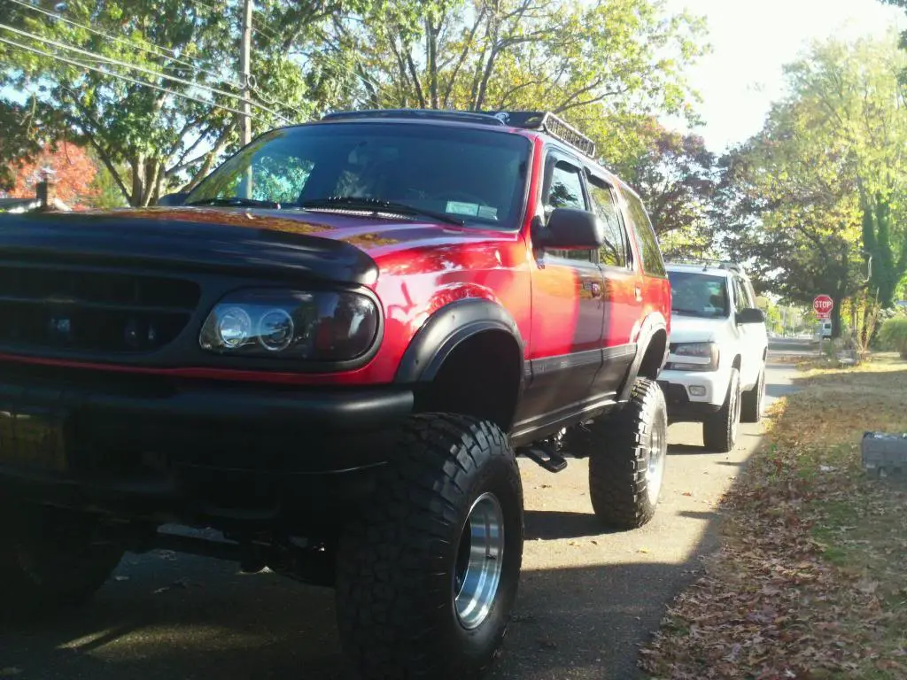

and the final product.
pics of the truck with pretty much every mod possible. haha
thanks for lookin
:salute:
just beautiful
Looks very nice!
