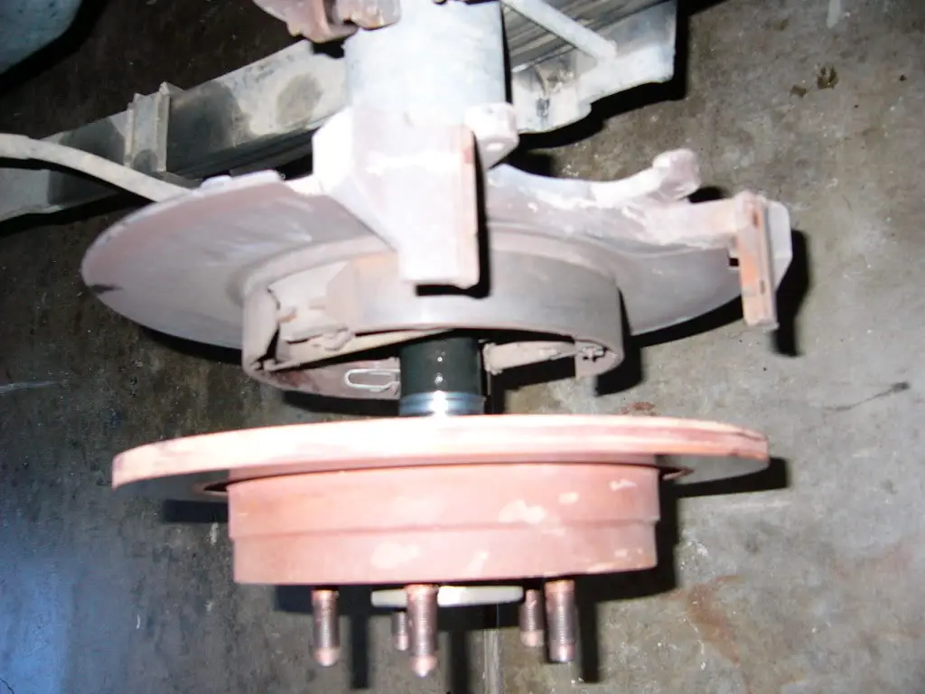

I have discovered that I have a massive leak out of the right rear axle. The bearing looks like it needs replaced. There is alot of movement of the axle.
I have the everything torn down but I do not know how to get the axle out. Am I missing something that still needs removed?
Do I need something to pull the axle out of the rear end housing.
Here are some photos of how far I have it broken down to.
I can't tell from your description or pictures, but have you removed the C-clips from the axle ends?

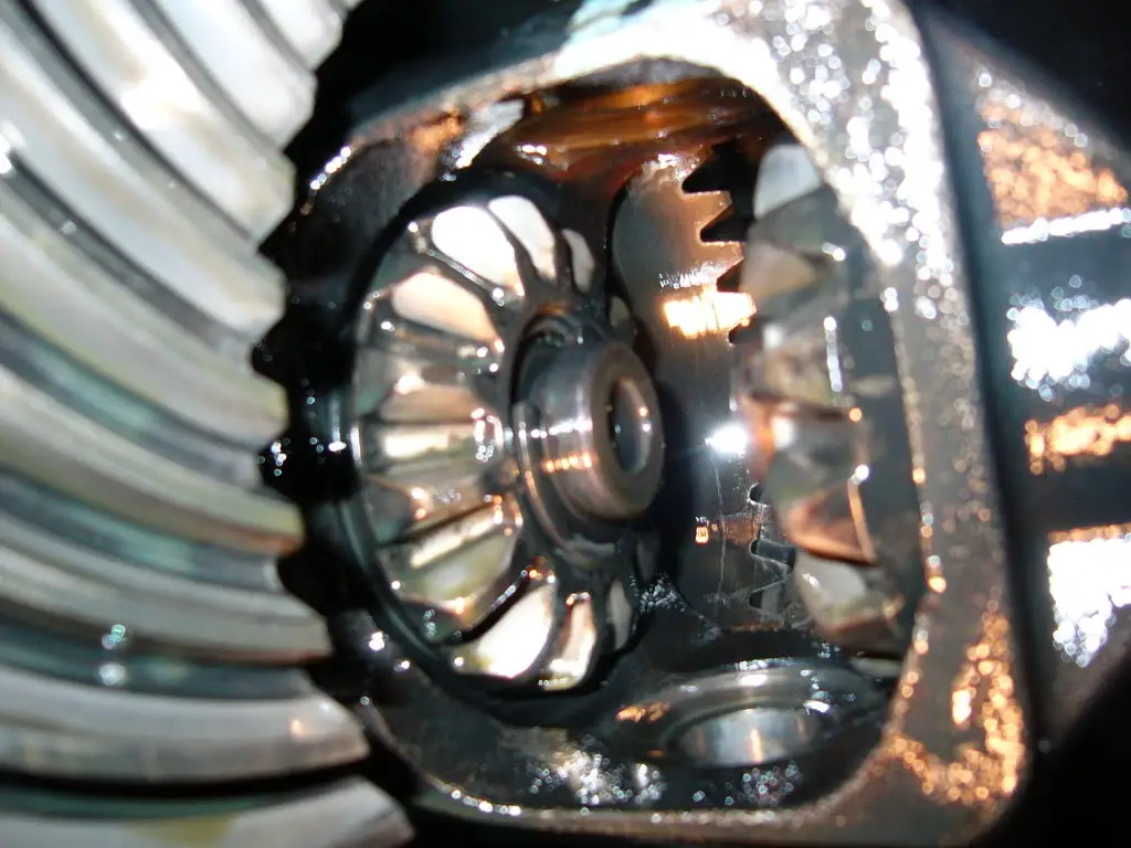

here is a picture to give you a good visual without the spider gears. with the spider gears removed, you can see the axle gears on the left and right of the carrier. in the center of the left axle gear in this pic, you can see the end of the axle, and the c-clip holding it in place (c-clip looks like a U in this picture).

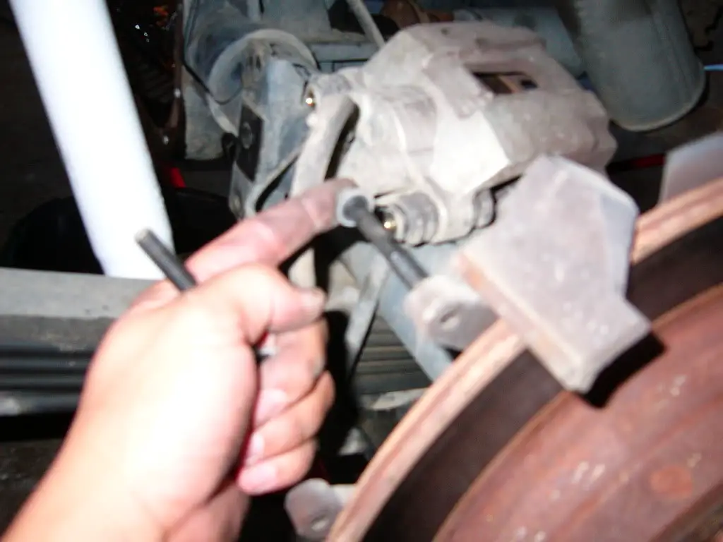

how to remove the c-clips? you have to remove the brake calipers first. there are two bolts holding each caliper in place, they are in the backside of the caliper.
with the calipers removed, you now have a little play with the axles. push the axles in, this will give you slack to remove the c-clips. then you can pull the axles out after the clips are removed, and then you can remove the axle gears. make sure you pull the thrust washers and the spider gear washers. dont leave them in the carrier!
