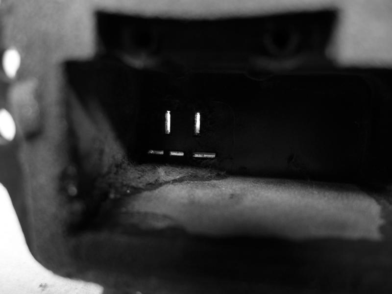

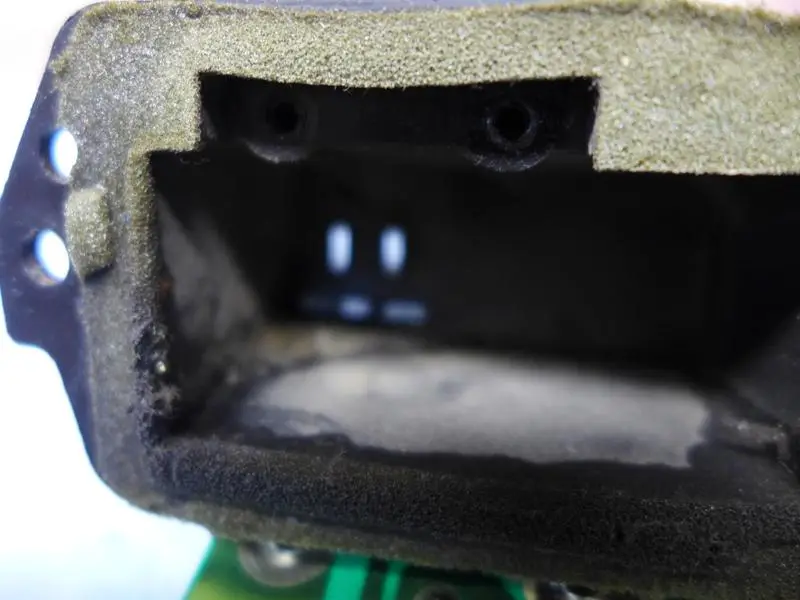

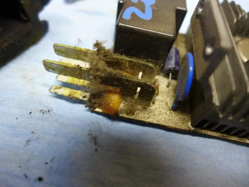

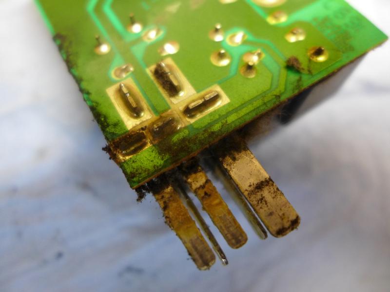

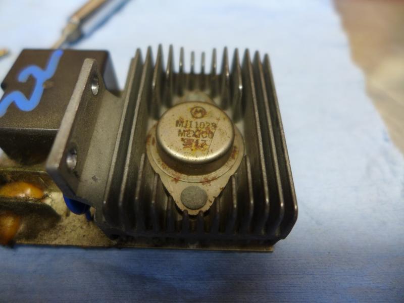

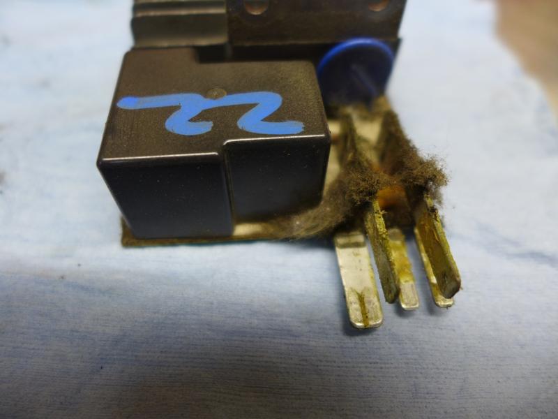

Back on line, at least for the moment. You need a 1/4"drive 8mm socket, some extensions, and a u-joint. Flip the cruise control module out of the way and you can remove the blower motor control module, with some patience. Then you need a #10 torx to remove the board from the surround. You might want to have some isopropyl, simple green (for the case), and a few q-tips handy. Don't forget to clean out the inside of the case. Cleaned and reinstalled, the unit is working fine. We'll see if it holds up.
That stuff piled up inside the case was a little damp. Hmmm . . . . Maybe I shouldn't hit those giant puddles quite so hard? But then, how am I supposed to get all that road salt off?
In case you want to see what I cleaned out:

A few more pics:

Still working after several weeks. Checking off as a genuine fix. M
P.S. For clarification, I did NOT resolder anything; just cleaned off the components.
