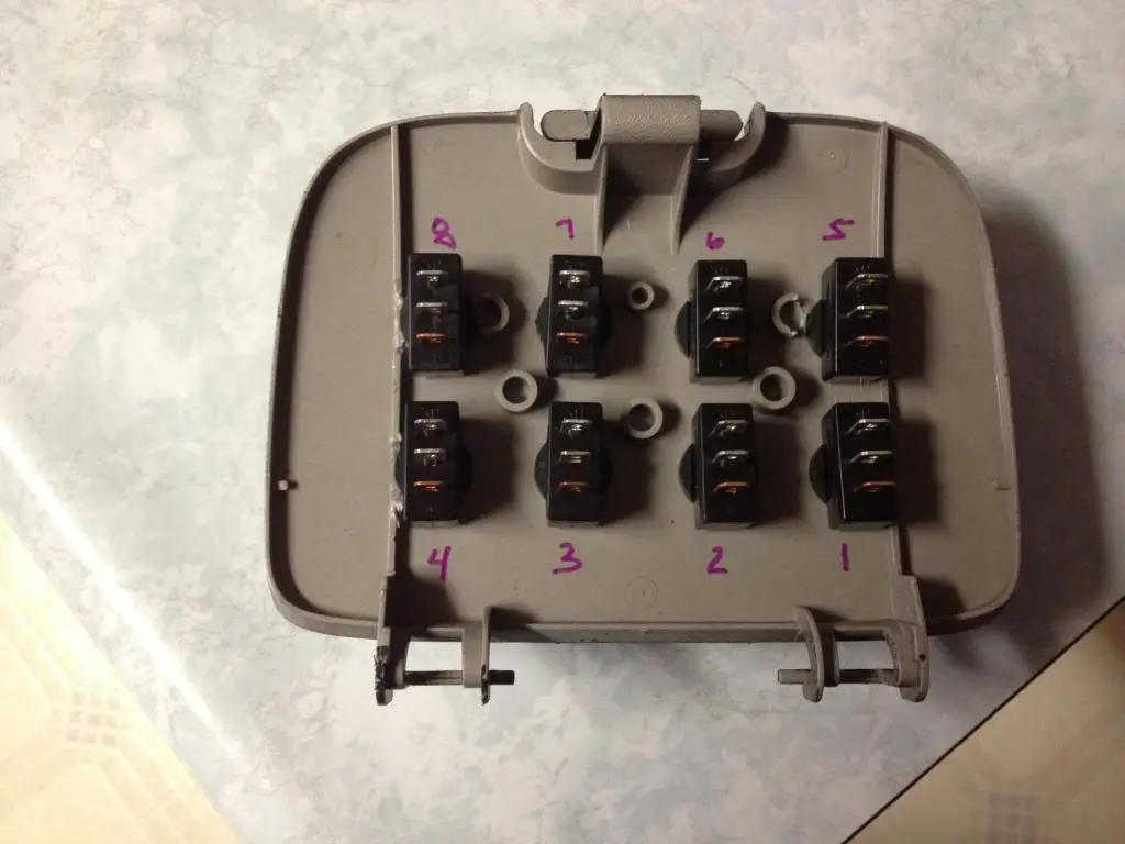

So I will give this a shot..hopefully I get this right. This was a little project I did that put 8 extra switches in my overhead where the garage door opener is supposed to go and a power strip from the battery in the interior of the car.
4 currently power front lighting. (4 are not in use yet) I also installed 3 buttons on the dash. (one is my brown wire mod.) I installed lighted switches in the overhead, I don’t recommend it. Although I really did like them, at night they are cool.. yet as distracting as a fig newton sticker on the windshield.

9. Up to 8 switches (don’t recommend lighted for the overhead)(ebay)

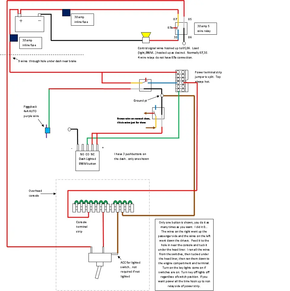

I made a power terminal strip that is powered from the battery to run the lights. (I will show where I ran it through the front of the truck soon) It is on the passenger side behind the plastic panel. It has two sides, one is always powered up from the battery all the time, in case I need that. The jumper for this power terminal strip is split …The other side is powered through a relay with the control signal being the piggy back wire for the original brown wire mod. (PS… this is all wired with brown, red or green wire, I have a lot of that)
Top of the strip is powered directly from battery (red wire blue white connector). Bottom is powered from the battery through a relay (blue wire is from relay). The red wire with the blue connector is the power up to the switches. This way when I turn off the car, all of the switches lose power and turn the lights off automatically…. I am horrible about turning off switches so I made it fail safe……Not hooked up is the green wire, power back up to the buttons in the dash for brown wire mod and other buttons.
The power for the lighted dash buttons come up from the relay side of the power terminal strip via a green wire to the three yellow wires. BWM control signal comes from the top button.. I am not using the other two buttons at this time. My BWM is wired to be on all the time unless I turn it off or lose power to the switch. (fails to AWD). The dash buttons were installed by drilling a hole in the locations for the brown wire mod on Ronin’s thread. (He is a sensei)

Remember to label all wiring….. The red wires are the power going to the switches. The brown were for the ground return for the switch lights. The browns are really not necessary if you are not using lighted switches. I prewired the wiring console terminal prior to installing. There are jumpers on the bottom of the console terminal strip, these need to be installed prior to gluing. The power from the power terimial strip comes in from the top side. I jb welded the 12 slot console terminal strip to the console. It fit quite nicely. I also drilled ½ inch holes in the console webbing to route wires.
Remove the garage door cover, drill and install the switches. I painted it black as well. Remember labels on all the wires and switches.
Route the wires and terminate. Almost ready to go back to the truck. (2+ hours later)
You should now have 8 wires going from the console terminal strip to the switches, and 8 coming back from the switches that will be wired in the truck. The wires should be jumpered at the console terminal strip with one hole open to power them all. If you install the lighted you need to run the ground return wire (brown ones)…. Jumper the underside, just as you did the other side. The ground will also be handy for anything else you want to power up there. (back up camera?) The cover will close.. its tight...but wait to do it in the truck
Back to the truck. Pull both the plastic covers on the sides of the front windshield. The 8 wires will go down the drivers side. The power and ground will come up the passenger side.
I hung the console in the car and wired the output of the switches to the 8 wires I bundled and ran under the headliner and down the driver side plastic piece. Those wires were about 10ft long and went through the firewall just behind the vacuum booster for the brakes. (I don’t know if that hole is there on some of the other year models.) These wires hook directly to the control power for any relay you want to operate. Hook the output of the relay to ground in the engine compartment.
This hole is the same one I ran a power line from the battery with an inline 30a fuse to the power terminal strip I first mentioned. It runs through the hole under the dash, there is a little space to run the wire across to the passenger side.

Note the 2 wires going to the right (passenger side) in the picture. One is the power line coming up from the powered terminal strip and the ground line going down to the ground connection used for the BWM. They both are under the head liner and down the passenger side. Hopefully you remembered the labels…

I only have the first 4 switches doing anything at this point… 1 for bottom light bar, 1 for halo’s , 1 for fogs, and 1 for the lights on the bar. They all operate independent of my headlights, and auto turn off when I shut off the car. The wiring through the relays is pretty straight forward but this is mostly for installing the control power switches for any relay you want to use.
Hopefully this is useful to someone else, it was a cool project. It turned out better than I thought. Hopefully I didn’t violate any rules…
Here’s a wiring diagram… Jpeg a bit sloppy, but hopefully it works. Photobucket won’t take a pdf.
