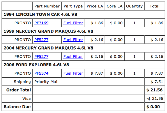

My '94 Town Car, winter beater, was leaking fuel, and it turned out to be the original filter rusted through. I decided to grab one at Rock Auto, since they're so cheap, and I can wait till it's mailed in. Figured I might as well grab one for the Explorer, and a couple other cars:

About your Town Car Ornery,
By the look of your receipt, you can just get another Ford with the 4.6L V8 when the Town Car dies!
