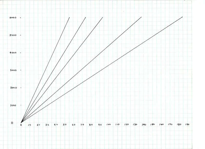

determine start out gear
For the 5R55E when starting out in "D" the transmission should be in 1st gear and will quickly upshift to 2nd speed (1st & overdrive). When starting out in "1" the transmission should be in 1st gear and not upshift. When staring out in "2" the transmission should be in 3rd speed (2nd gear) and not upshift. I don't know if the 5R55S performs similarly. The graph below shows my engine speed vs transmission speed with a 3.73:1 axle ratio.
I suggest that you confirm the vehicle is starting out in first gear and not 3rd speed.

After verifying the above graph, if you determine that the trans is shifting at those numbers (R&P ratio won't matter) and you are within range, I would HIGHLY suspect the throttle pedal assembly as being faulty. Had it happen on a F-350 several years ago and it sounds very similar to what you are describing.
