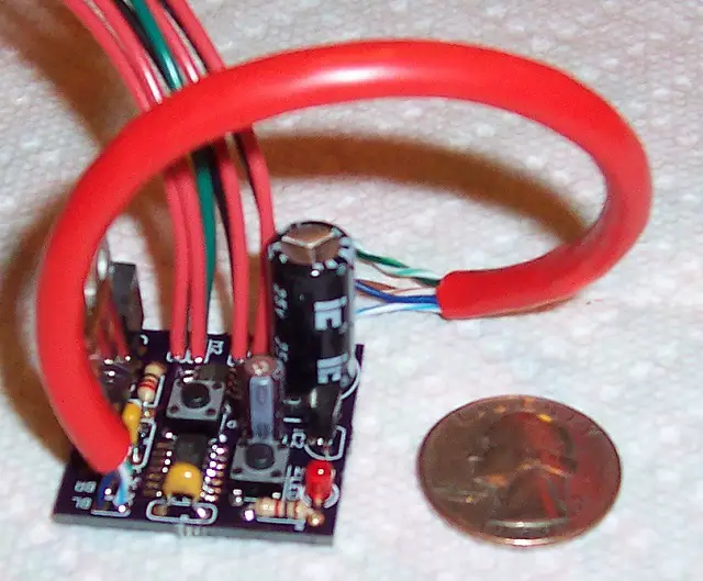

However, this photo of one on a 2001 E150 shows more wires.
I plan to install an electronic fuel pump controller in that near the inertia switch.
I'll check my switch connector in a day or two and see how many wires I have.
