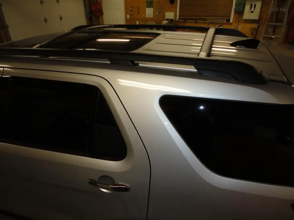

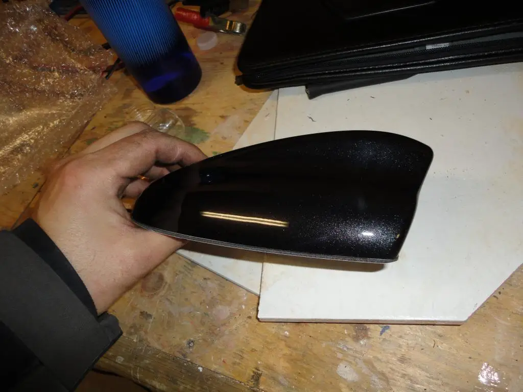

Just thought I'd post a couple pics of a Shark Fin Antenna Install.
I've had these on other vehicles and they look and work great. Never really noticed any reduction in reception...at least not where I live.
These are purchased from Visual Garage. Their site is still that page with a notice of a new launch coming soon but you can still order these by emailing them, they will reply back asking your vehicle make and prefered color, then they will send a paypal invoice, you pay, and a week or so later your antenna arrives.
Ignore my grubby hands. Before hand, I installed my HID kit which I will also soon be posting another thread and a lot of similar step by step procedure pics.

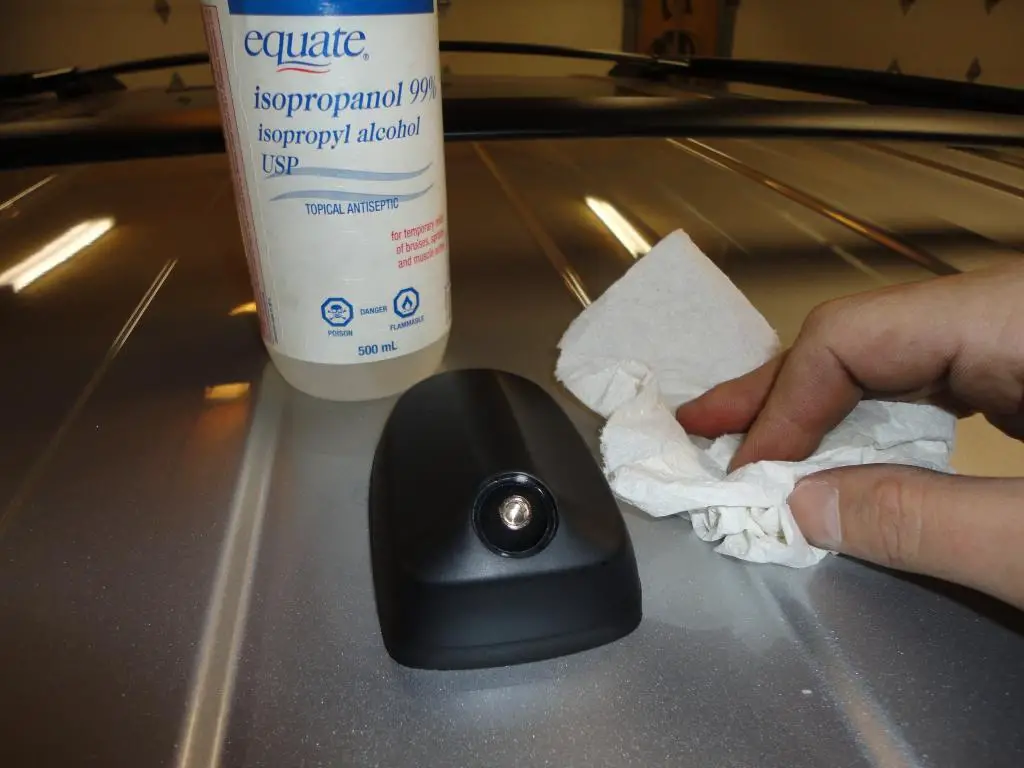

UNSCREW AND REMOVE FACTORY ANTENNA
CLEAN AREA AROUND ANTENNA WITH ALCOHOL TO ENSURE GOOD CONTACT FOR THE ADHESIVE TAPE.

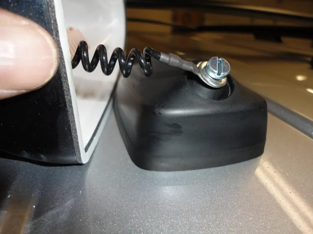

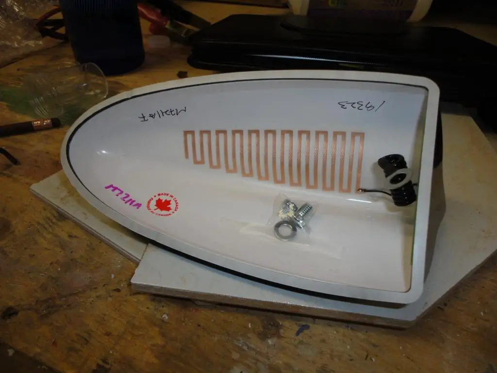

ATTACH SHARKFIN ANTENNA WITH PROVIDED SCREW

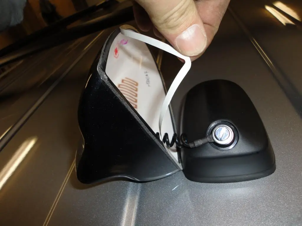

PEEL OFF ADHESIVE AND ALIGN YOUR SHARKFIN ANTENNA AND STICK IT ON

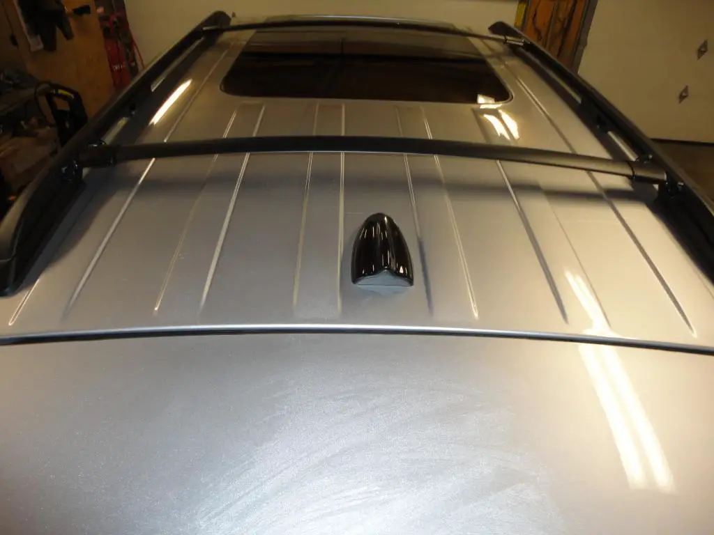

Thanks, i had no idea it was that simple. Have you tried both am and fm reception?
You are right... Super simple and working great in both receptions.. Will post a pic soon of mine...

Do you thing this will hold up in car washes. I like next to a Delta Sonic Car Wash and go take my vehicle there three times a week. Just wondering how the tape holding the antenna will hold up. P.S. Looks great on your Explorer !
Before putting this on my new Explorer I also had one on my old vehicle, a 2011 Chevy Equinox. It was on there for 3 years and I wash approx once per week and never a problem. My mother now has my old Equinox and the Sharkfin is still holding tight as usual.
If you really weren't sure you could always go buy that special 3M automotive double sided tape, cut a long thin strip and replace it. But really, the tape that comes on it is just fine.
doesn't it seem to be too big?
Too big for my liking ;.). I'm actually looking into how to move the whole antenna off the roof, to make it completely flat up there.
