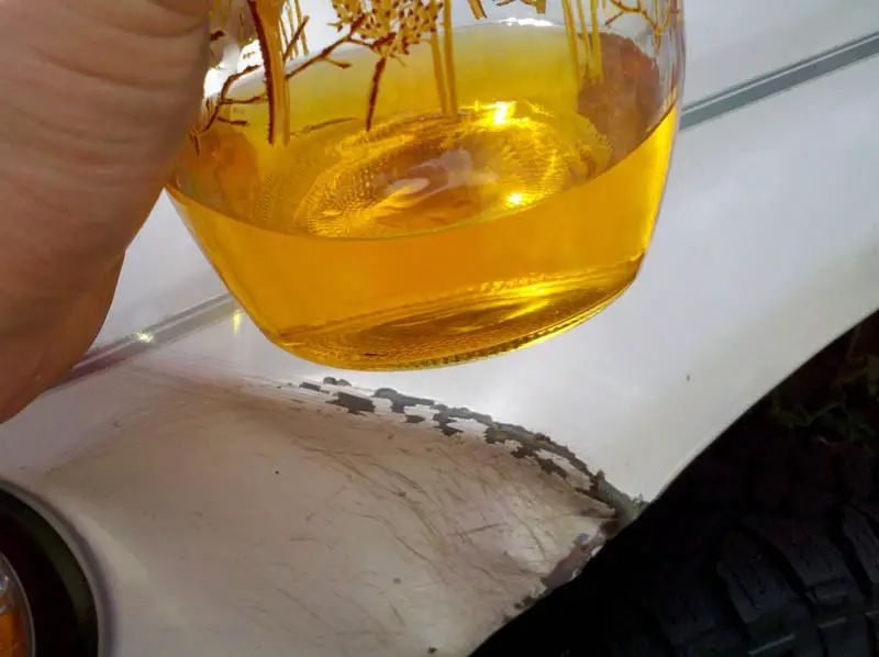

drain the fuel
Even if the previous owner added fuel stabilizer to the fuel tank before parking the vehicle the fuel after several years has probably changed to non-combustible lacquer.
I suggest adding to your just before engine start to do list:
Drain the fuel tank
Check the drained fuel for rust in the tank (replace tank, pump & sock if rusted)
Replace the fuel filter
Get fresh fuel all the way from the tank to the fuel rails
Test the fuel injectors for being clogged (if not clogged add a bottle of Techron to the fuel tank)
