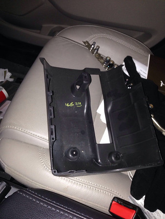

Replacing the switch is about a 2 on a 1-10 scale. There are 3 7mm head screws on the underside of the steering wheel. If you have an adjustable steering wheel, pull it as far out and down as possible after removing the screws.
The plastic cover splits horizontally. On each side, it has snap connectors at the front corners and along the sides and a hook connector at the rear. I rotated the steering wheel to access each side more easily. After the snap connectors release, rotate the top cover back and set the bottom half aside.
