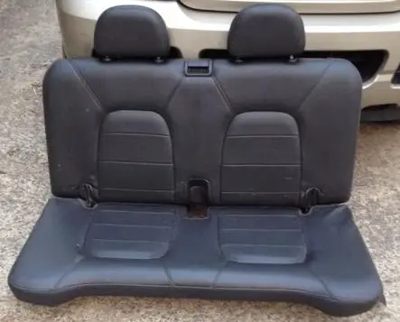

Now, if you have black leather interior, you should make the change and give me your third row.

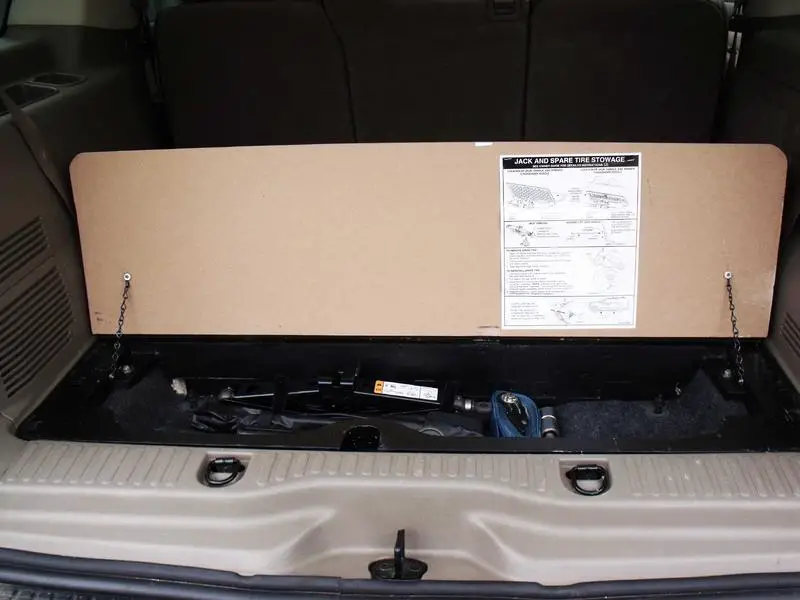

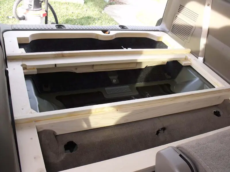

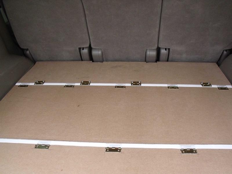

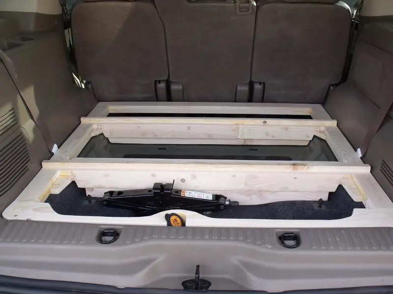

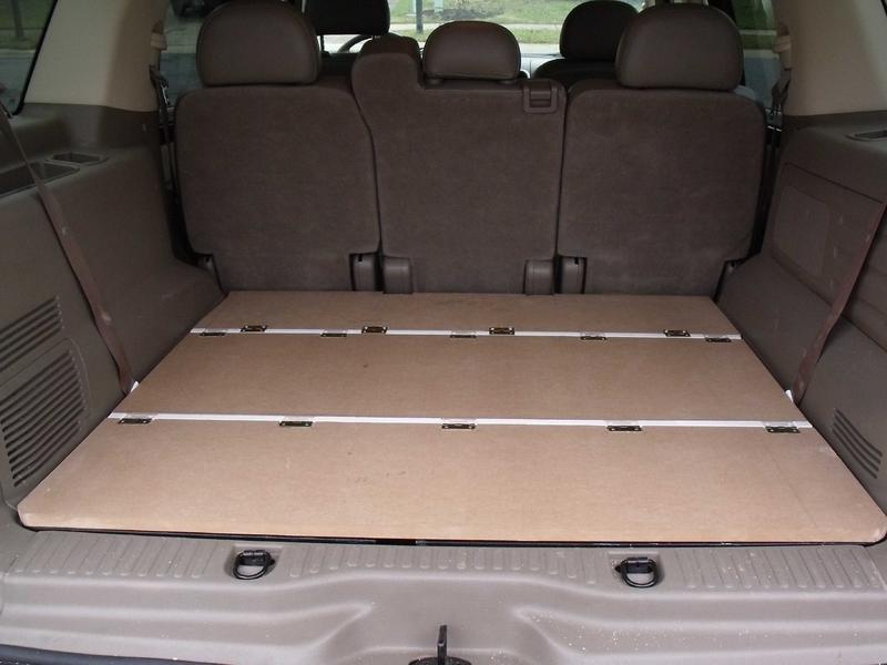

I removed my 3rd row seat. I built a flat platform with flip-up trapdoors. I am on the road until next week, I have a set of photos at home in my pc that I can post if your not in a hurry.
No hurry. Would love to see them. I saw a thread of one homemade unit but would love to see more as I could go that route.
any junkyards near you? i'd check that out..not sure how far upstate you are but on the way to my house in Columbia county i see quite a few LARGE yards...all very organied probably by make and model. If you don't like that, have you considered in completely removing the storage compartment at the rear, the whole third row and going down to the metal? throwing some bedliner on that and making some compartments would be sick
you could also turn around and sell your third row for a pretty penny
I used a good grade of 1" x 4" Pine. I glued & used screws to make frame. I used the locations of seat bolts to bolt frame in. On the front of frame at 2nd row seat, I used turnbuckles with hooks attached to child safety loops to hold frame in place. I can pull the whole thing out & put 3rd row seat back in, in about 45 minutes.
That's some nice woodwork.

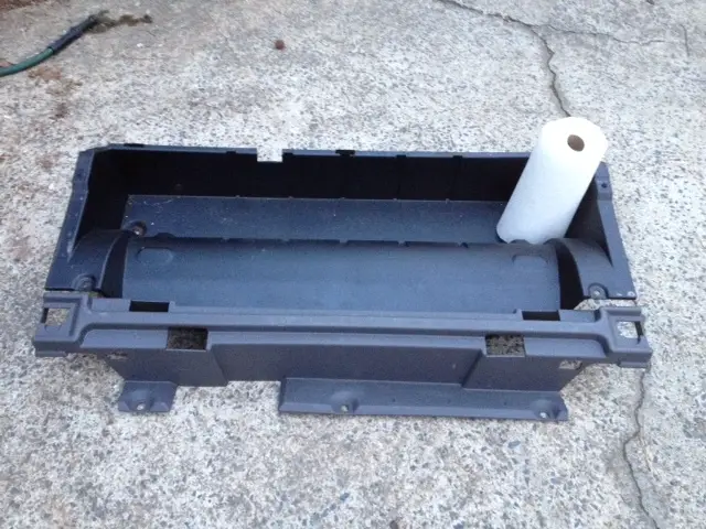

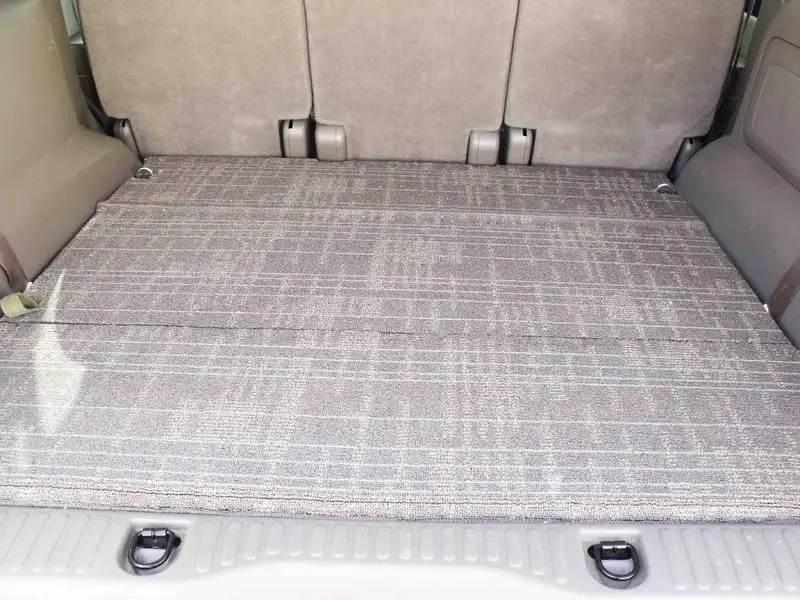

Here are some photos of my Ex with no third row (for the moment.)
The paper towels in the one pic are for size.
Now, for me? $65 for this beauty out of an 05 Mounty.

Thanks for the pictures!!!
I love the idea of making a wooden one just not sure if mine would come out as gorgeous!! That thang is nice!!!!
That is brilliant!
