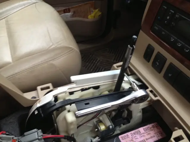

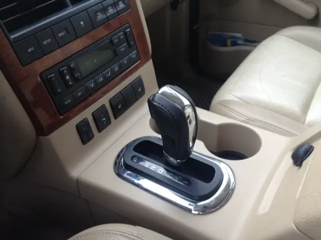

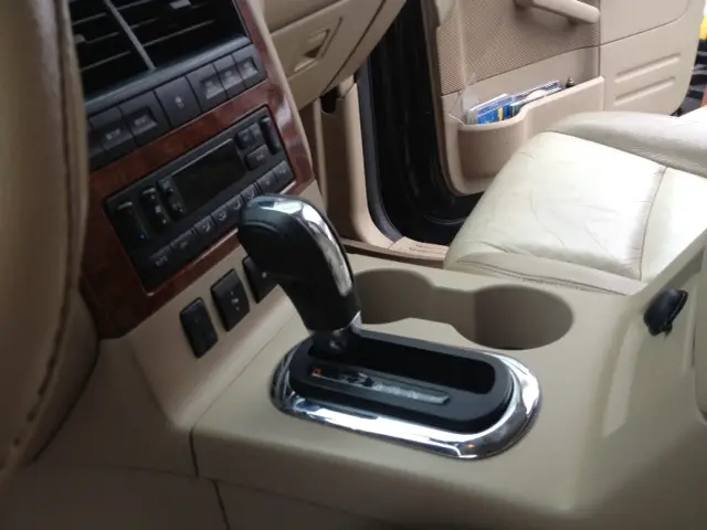

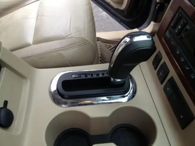

I did that mod too and so far I love it. The knob has that modern look and it just looks better. Also, what should be a $5 replacement of the chrome cap:
http://www.explorerforum.com/forums/showthread.php?t=403304
is in the best case a $60 replacement of the whole handle from F150 if it fits - I did not verify that, or you need the whole shifter assembly all the way to the floor for $ 180 - I could not do that.
So for $17 on eBay I got a new OEM Flex shifter handle 8G1Z-7213-A
Few additional points on top of the ones included by Bluez and Pony:
Cut the OD wires so you leave as much as possible on the Flex handle, and cut the plug off the Explorer one with as much wire left with it as possible. This way I just heat shrinked them together without adding an extension.
I did not have time to order the 4mm tap so I just bought 2 4mm bolts at HD for $0.70 each and used them to tap the holes on each side.
while I had everything off, I also removed the ribbon since it had so much junk between the ribs, and I cleaned it with warm water and soap. I also cleaned the top console cover.
Be carefull with drilling the holes. My second hole on the driver side is maybe 1mm off and I can't get the set screw to catch, but even with just one, it is very solid. The original one was also set with just 1 (but bigger).
The whole thing takes about an hour.

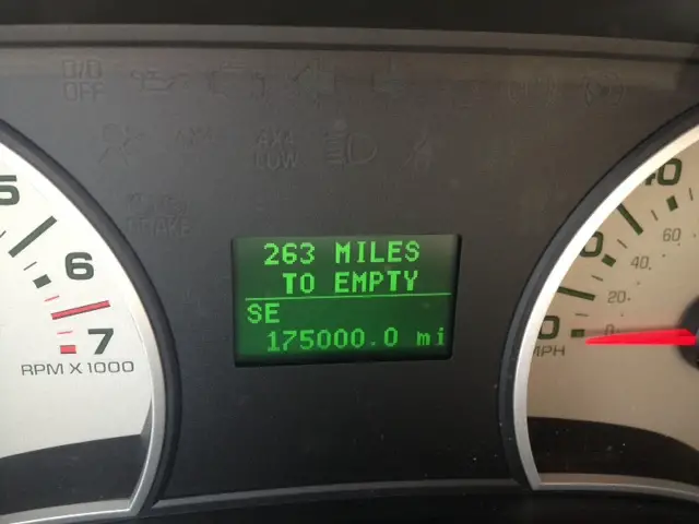

Also, at the same time I noticed my odo had a nice even number:
