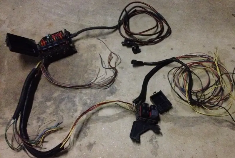

This pic shows the entire Fuse box, secondary relay box, harness and power supply line.
This fuse box still had all it's goodies in side.
Basically, as I've noticed, this fuse box setup sets on the other side of the engine compartment from the battery. So you end up getting a "remote" fuse box with a long power lead to run to your existing fuse box. No need to attach directly to your battery, you can utilize the battery connection point to your existing fuse box. Cleaner install this way. This will fit perfectly in the passenger side of the engine compartment in the open space.

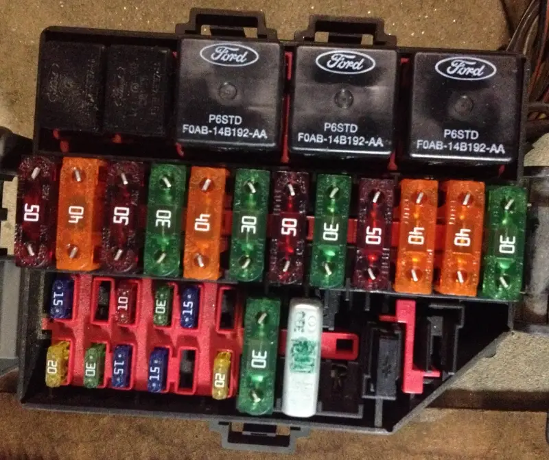

I was after this originally because it has the electric fan connector I want for my fan mod. I'll be able to utilize the fuses and relays that were OE with this unit. (Sorry the pic is rotated, couldn't get it to stay corrected.)

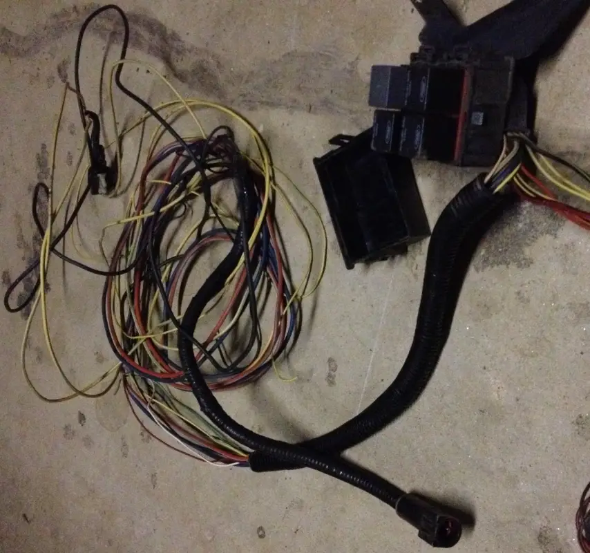

You'll also notice I maintained some wire leads from the rest of the fuses. These can be utilized at any other point for other gizmo additions.
They rang me up $15 for the fuse box and $17 for the "harness."
The relays alone in this are worth far more than that.
