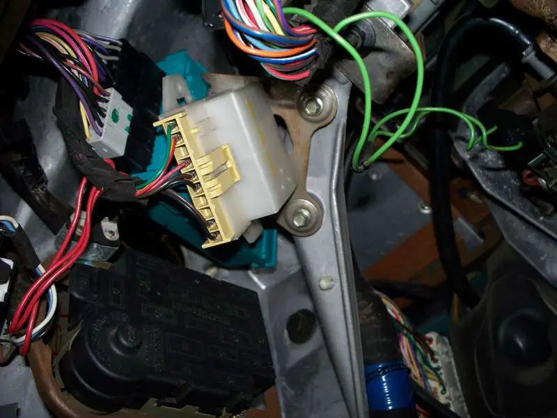

Let's get started with the basic removal of the module. It's located under the dashboard on the driver's side in the Aerostar next to the chime module:

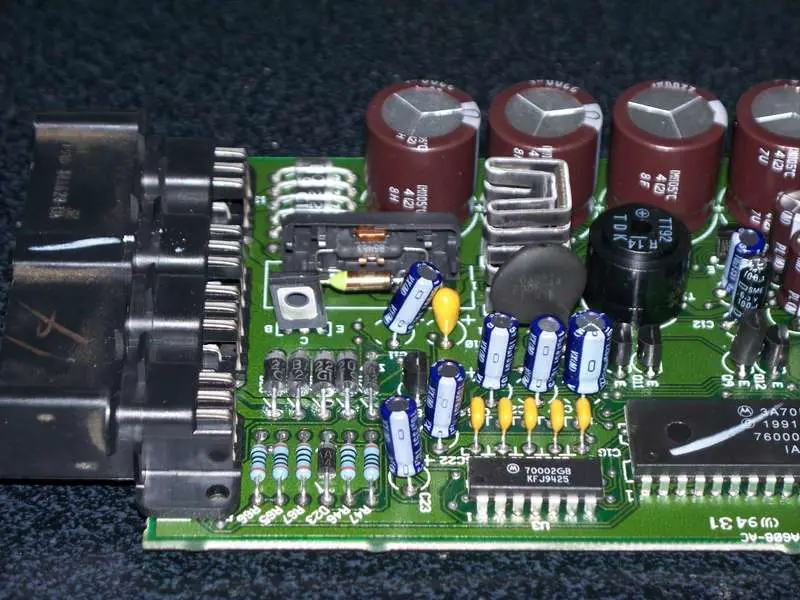

Here's a close up view of the circuit board:
The part that has to be opened is on the right hand side of the photo above. It contains a 15 Ohm resistor, and a 167* C thermal fuse which are thermally connected by a copper clip inside the plastic housing. Here's an internal view with the case removed:
