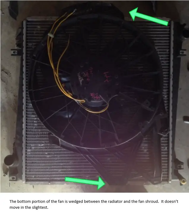

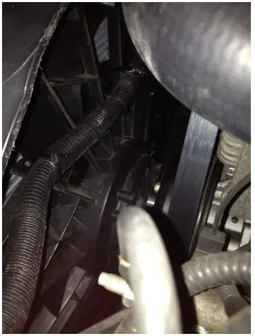

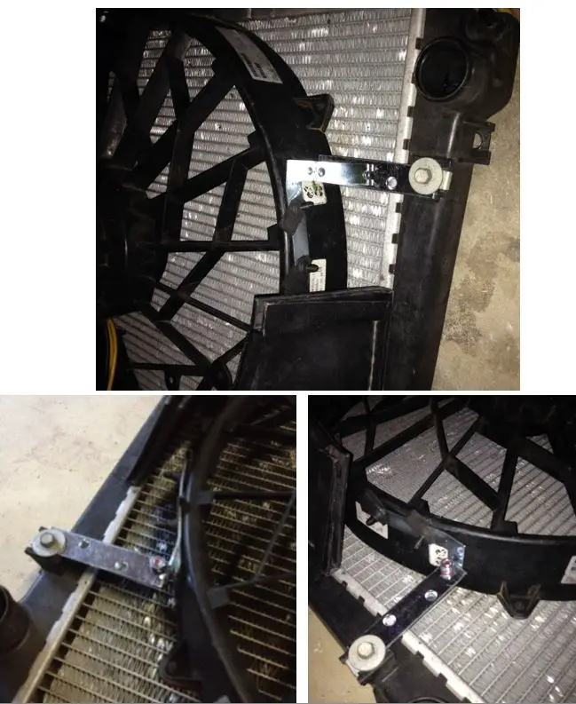

I thought I'd post the information on my e-fan install for my 3rd gen 2004 Explorer with the 4.6l V8. I did this in March of 2014 I think, I really don't recall anymore. Unfortunately, I've lost some notes as well. So it'll mostly be pictures. A lot of pictures, so it may not view well on your phone.
I didn't land a Mark VIII fan and frankly I'm glad I didn't. I did get a fan off a Lincoln town car or something that had the 4.6l. It had an inrush well over the limits of my gauge (100+ amps) and I couldn't find a way to limit the inrush. I ended up with a fan out of a 2001 Mustang GT. The Mustangs inrush was just under 60 amps IIRC and ran at just under 20. If the fan was good enough for the 4.6 in the Mustang, I figured it had to work good for me. My Ex runs at 195 with the fan going (when needed.) On the hottest day in Atlanta, in the bumper to bumper traffic, the temp reached 212.

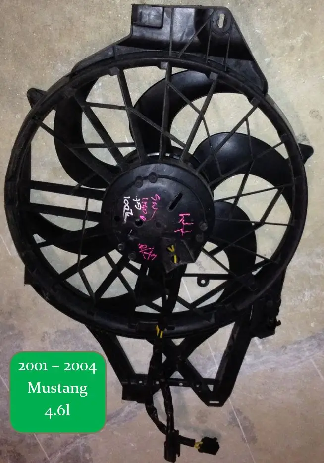

Mustang fan.

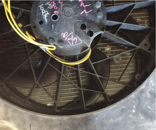

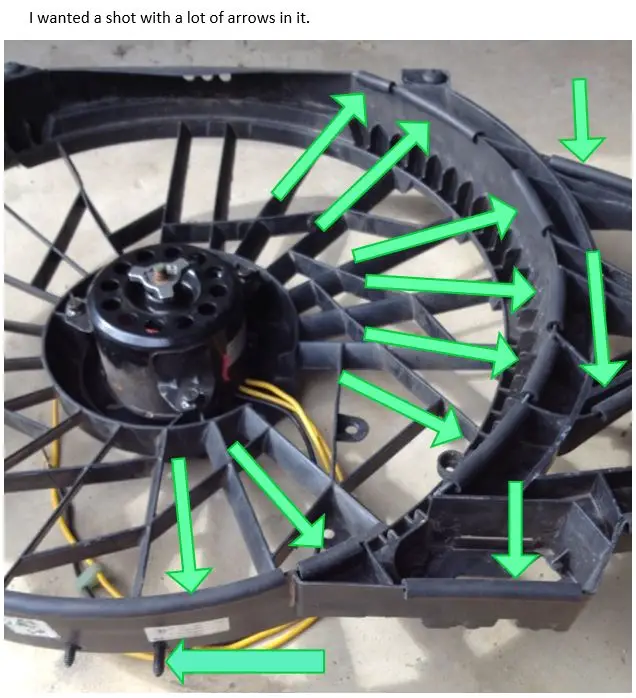

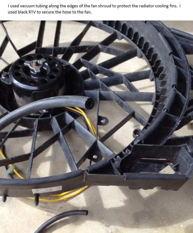

My cuts to the fan.

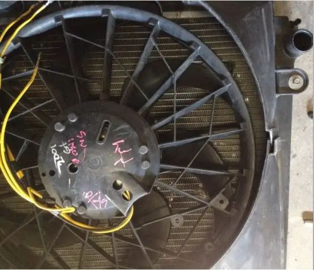

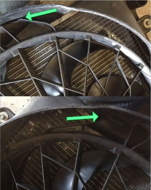

How the fan will set in the fan shroud.

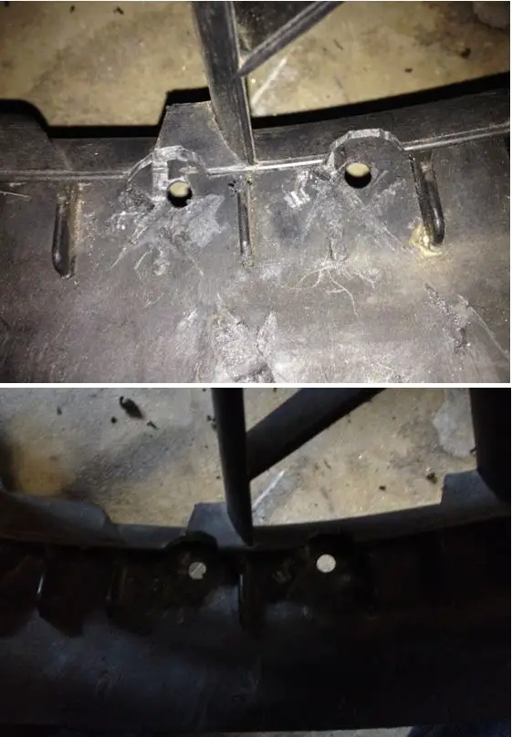

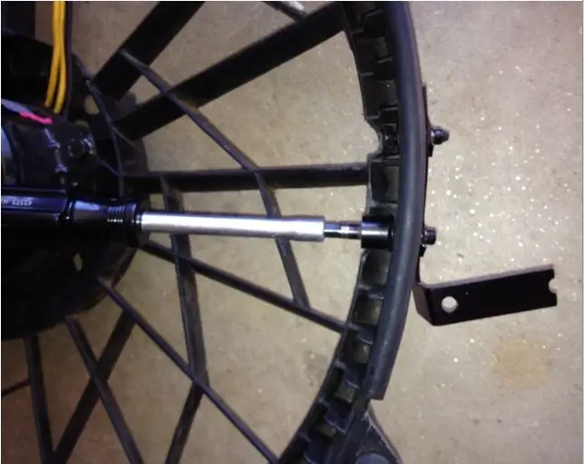

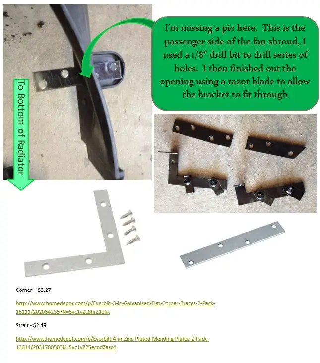

Fabricated brackets to hold the upper portion of the fan in place. If I wasn't so lazy, I'd take these to someone and have them fabricate solid pieces. If I did that though, the fan still wouldn't be installed.

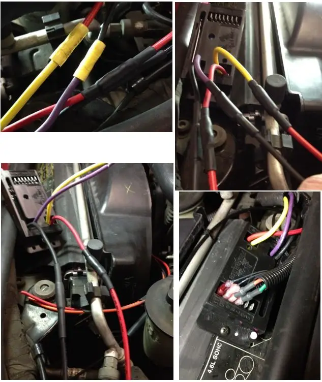

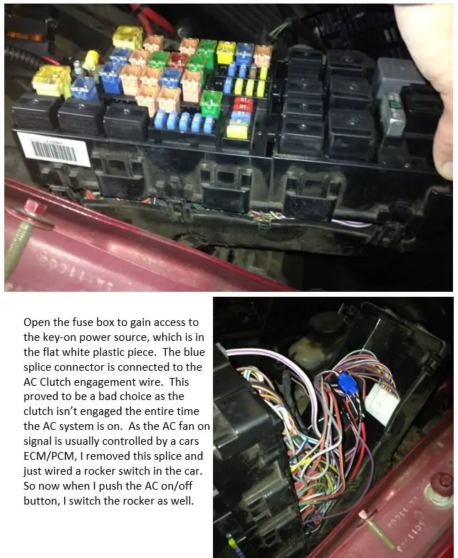

Biggest issue was the fan constantly cycling on and off. I found my AC wasn't very cold with it hooked up off the clutch cycling switch. Like than fan didn't stay on long enough to impact the refridgerant.

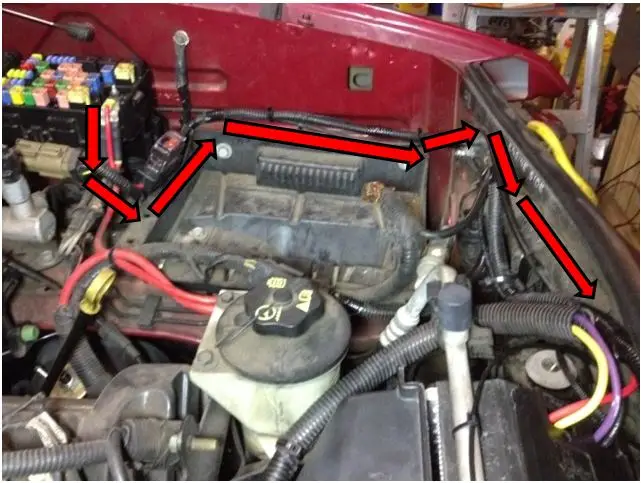

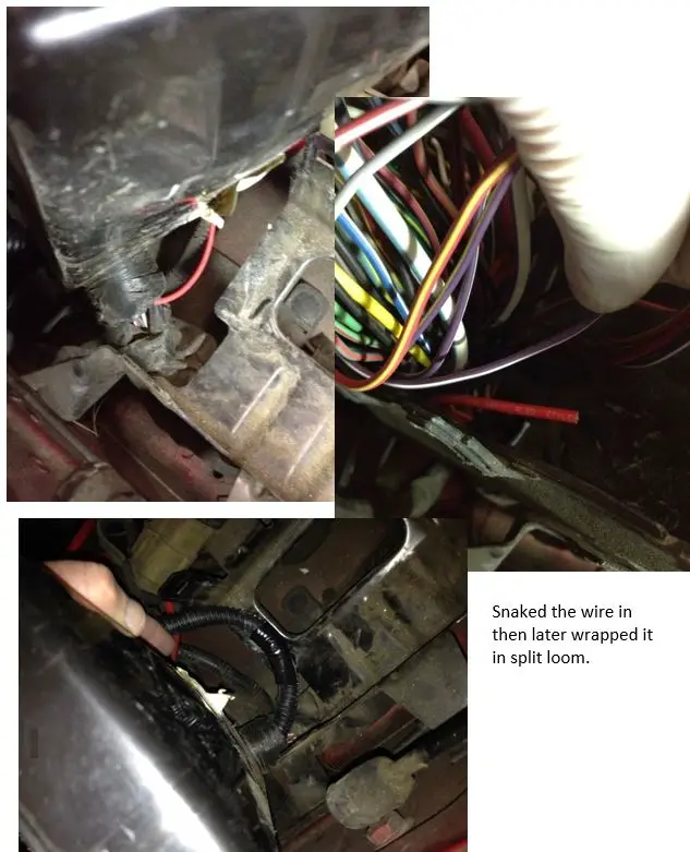

With the Flex a lite controller, the AC line feeds the fan at 60%. Using the rocker switch setup also gave me the ability to manually turn the fan on (at only 60%) when in stop and go or long lights. Otherwise, the fan would kick on, run for a sec till it cooled the engine, then shut down. Only to have the engine heat up again and come right back on.
So now, I can manually operate it as well it automatically comes on when the engine reaches 206.

Your are lucky that your 01 isn't a CAN BUS system. Tapping into the signal wire for the third gen will interrupt the signal frequency and disable the circuit. I verified this with a lighted circuit tester. As soon as it was applied to the AC signal wire, the signal dropped. I was really really hoping it would have worked as it would have been the best option.
So now I press two buttons instead of one for ac.
