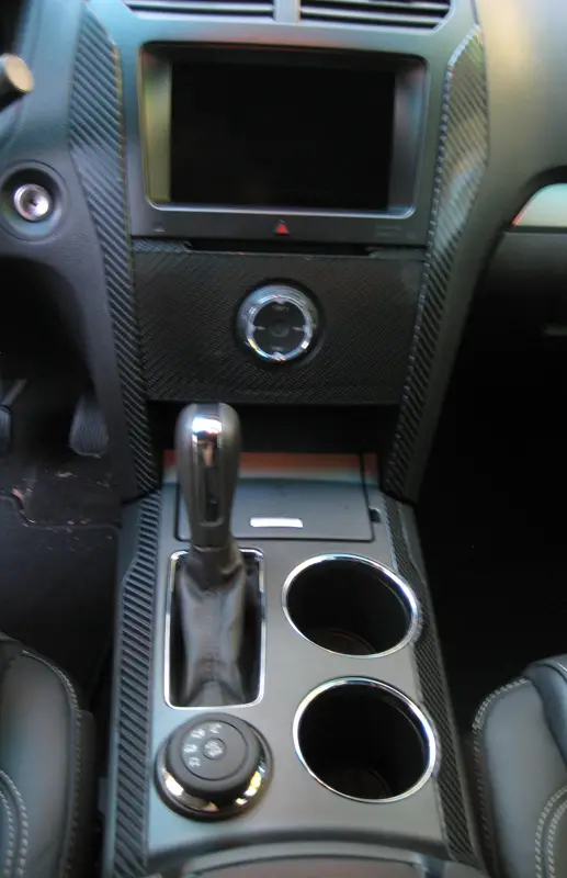

The light aluminum trim wasn't really doin it for me, so I'm wrapping all these pieces in a carbon fiber patterned vinyl. So far I've done the center console. I'm still trying to figure out if the AC vents and door trim can be removed. It's easier to wrap when you have the pieces off, especially if they have any depth or complex shaping (like the door handle trim). The steering wheel is gonna be a nightmare!

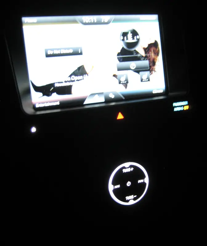

This guide was helpful: http://www.instructables.com/id/How-to-wrap-your-interior-trim-with-3M-carbon-fibe/?ALLSTEPS ... but I don't recommend cutting the corners like it shows. All buttons on the lower section of the console are duplicated on the MFT screen, so I decided to make the lighting less busy. They can also still be pressed through vinyl... so if you know where the buttons are, no harm done ;)

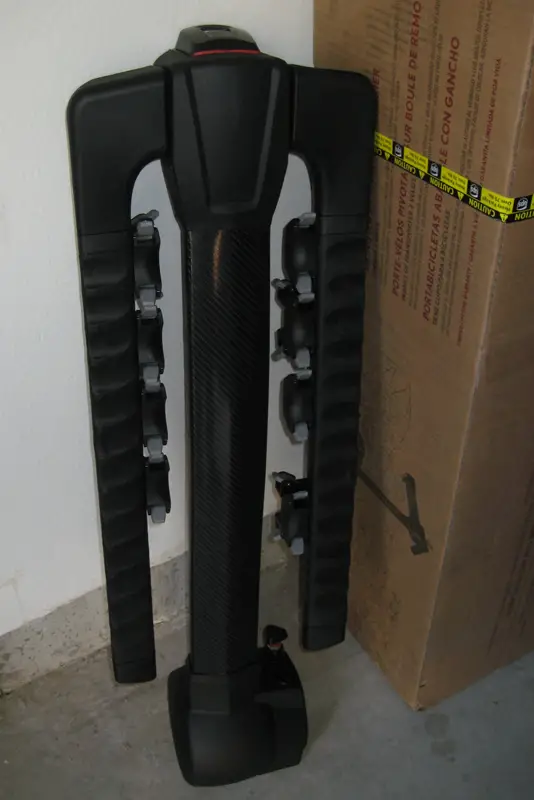

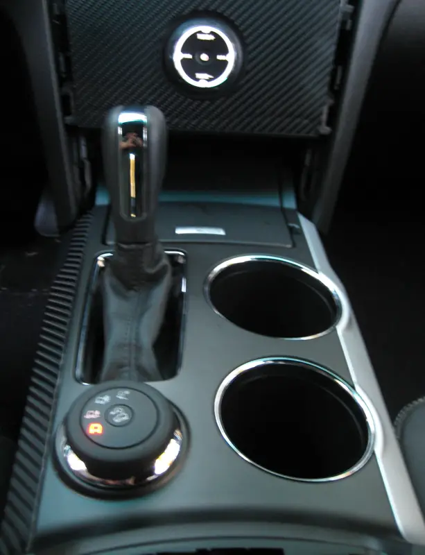

The finished product (sorry about the blurriness)(I wrapped my bike rack while I was at it :D):

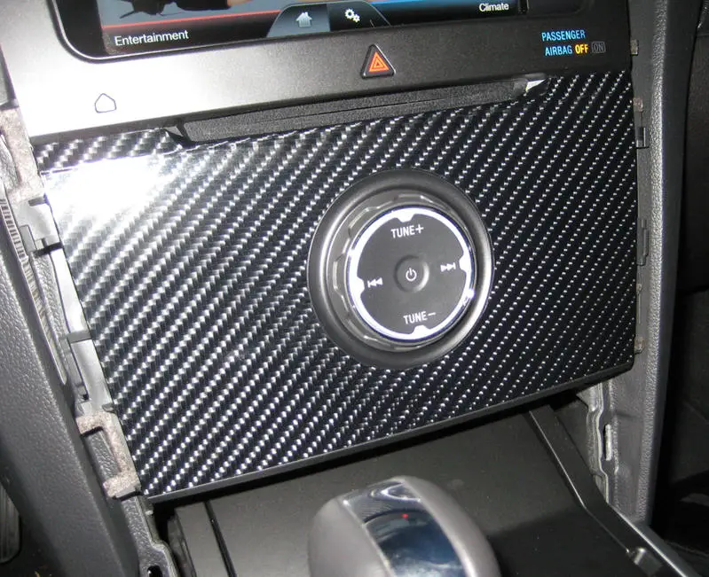

:thumbsup: Here's a couple more pics mid-install. The first one shows the comparison between the stock aluminum and the carbon fiber side by side.

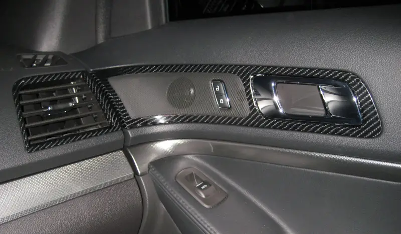

update: did the door handles and AC vents. only thing left that's light silver is the steering wheel, which is gonna be a real *****.

The other parts I installed the vinyl on while they were still in the car. Sometimes this is easier, as you're not having to hold something while you're laying/stretching the vinyl. It may have even worked out better if I wrapped the door handles this way too.
