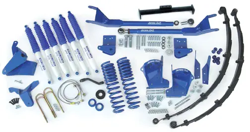

the James Duff 5.5 is a complete deal,, rear too ,,
it has everything ,
that i do not know,,
most guys use the Duff kit that i know of,,
I can't speak for Superlift.
The Duff stuff is top shelf stuff and very complete.
I'm running the stage 1 brackets and long arms. The kit pictured really is a complete kit. Extended brake lines and drop pitman arm to boot.
If you have the money, buy Duff!

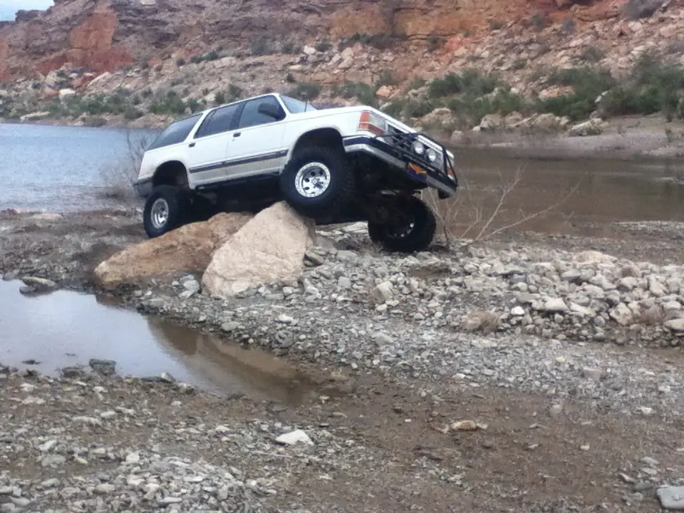

I ran duff 3.5" coils (I'm pretty sure that is what my replacement set was) with f-150 spring seats with Duff 2.5" kit axle pivots as our last lift combination before the cut/turned beams.
I ran my own extended radius arms and long travel shocks (f-250 shock mounts) since we started with the Duff 2.5" kit without arms.
The combo ran well, flexed well, but as Albino 94LTD said, droop was limited by the lack of spring (spacer doesn't flex) but the Duff coils themselves flexed well.
You can see the Duff coil extended all the way and the other one compressed almost completely in the following pic (click on it to see it on flicker so you can view it full screen). If you don't do the f-250 shock mounts and longer shocks you won't get that much travel though...
Truckhaven-mlk 2012 -5 - close up by maniak_az, on Flickr
Oh yea, I had no problems aligning things with the Duff 2.5" or Duff 3.5" springs with the f-150 spring seat using the Duff 2.5" lift drop brackets.
And last thing.. With the extra travel I was getting while using the Duff springs and the tight mount of the lower spring to the beam I managed to break a coil spring twice. If you look in that pic above you can see the spring is trying to bend 2 directions which isn't exactly good for them.

Ill chime in on superlift. .starters I dont think they included the extended RA arms, mine did not...from the picture you posted of it it uses the old doughnut bushings and drop brackets that lower the stock crossmember. .. ..my kit came with the brackets to lower the stock crossmember but no longer arms or anything. ..o and I only paid like $750-8500 for my complete kit so may be the difference, but using drop brackets and that type of bushings doesn't even compare to JD..jd uses its own crossmember, hemi joints and SOLID long arms..
I currently still run superlift pivot drop brackets and soa for rear..BUT I have upgraded to JD long arms and soon dual shocks..the superlift pivot brackets have been known to crack but a triangular gusset can be added..mine still have not and I beat on it...
Long story short..GO WITH JD...alot of people start with cheap kits like me and normally all end up with JD...
The Superlift kit you have pictured comes with their radius arms. I think you have to remove the old rear RA mounts. The kit comes with a new mount as the new arms are too long to fit in the OEM mounts. I think its the brackets in the center top of the picture. The design also does not allow for a lot of flex, as the shocks will contact the arms if you modify the suspension to flex more than the kit allows.
