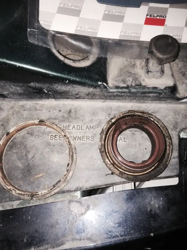

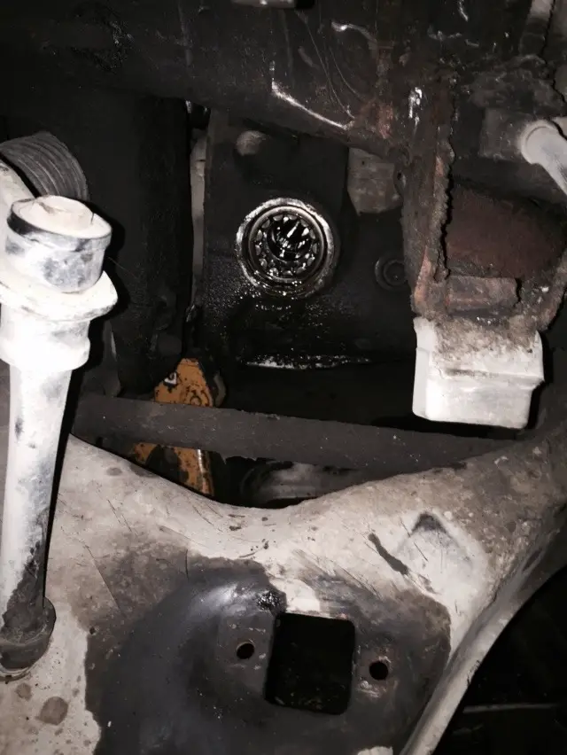

Well I think I found the culprit.....As you can see I had a pretty big leak :(
The outer axle seal is shot and the dust cover that meets the back of the wheel bearing is dry rotted and cracked gonna try and find a new one!!

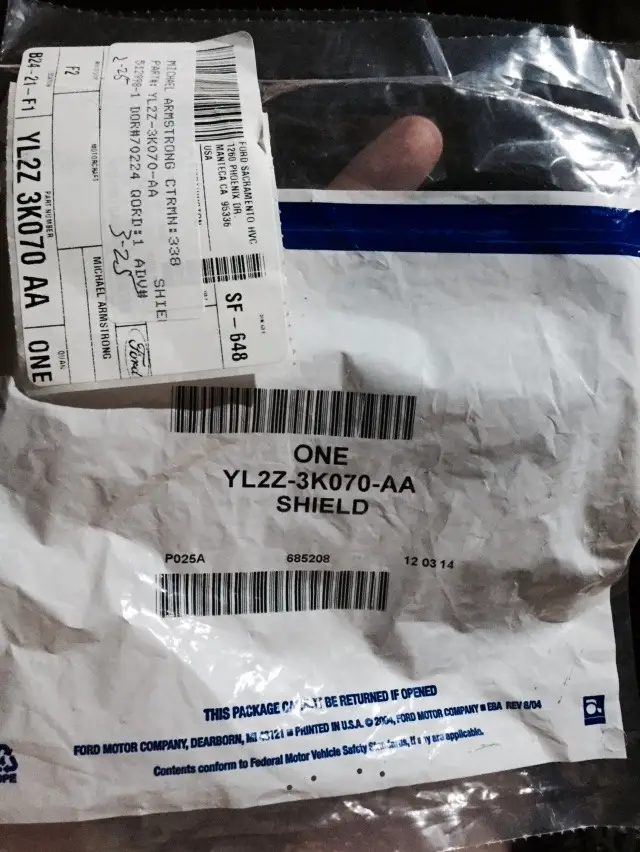

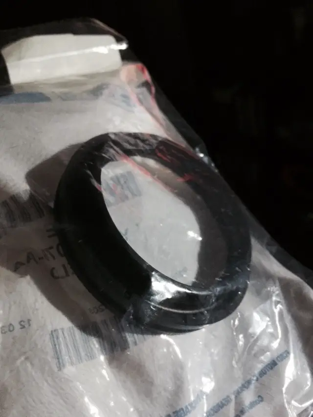

Ok so I found the axle to Wheel bearing shield if anyone needs to locate it here is the part number and what it looks like
