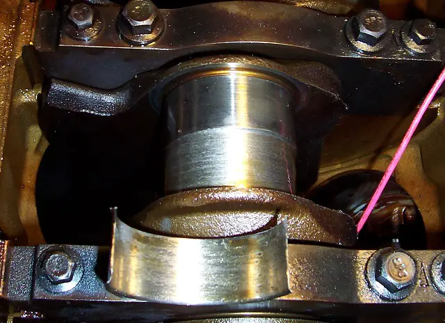

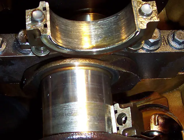

spun bearing?
I purchased an out-of-the-vehicle DOHC 4.6L engine from an Aviator that had a reported lower end knock. When I tore it down I found that two rod bearings had been spinning for a long time.
The crankshaft and two rods are unusable. I hope you have better luck.
