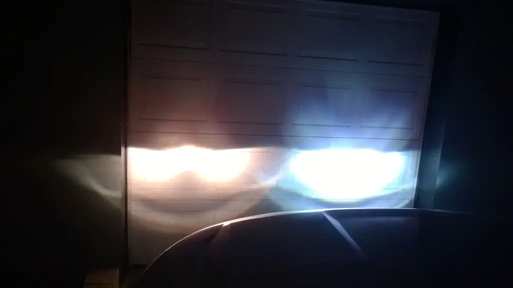

I and another member have upgraded our regular halogen bulbs to LED with these:
http://m.ebay.com/itm/161642725572?nav=SEARCH
LED will last the life of the car and these are very bright and put out a nice white light. They aren't near the price of a HID kit but are better than the stock bulbs. I would recommend them 100%. They are completely plug and play installation however you do need to secure the "ballast" box somewhere near the headlight.
Here is a comparison picture, stock bulb on the left, LED on the right.
Do these shine further than the stock bulbs, I am disappointed in the distance the stock ones project. Did you update the Fogs to be LED too?
Yes they are a combined 9000 lumens (claimed) and those Phillips 9011's (also another good option) are a claimed 4600 lumens combined. They shine further simply because they are brighter. I feel I see road signs illuminated further away plus have a better field of vision. Many are still very skeptical of LED's as headlights but I'm sold on them. I did upgrade the fog lights to LED however I only spent $12 on them and they don't put out as much light as I would like. I'll probably upgrade them to a better quality bulb later.
