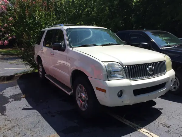

Preface: I bought a 2000 Navi (wrecked) for $400 a few months back. I'm planning on "dropping" it's 5.4 DOHC into and '02-'03 Ex or Monty. So I've been looking for a V8 with a 'bad' engine, thus cheap.
So this 2003 Mountaineer Premier 4.6l AWD with 204k miles pops up on CL the other day for $900.
Said they did a leak down test and Cyl. 1,2,3,5,7 and 8 are all 160-175. Cyl. 4 is at 110 and 6 is at 115.
Also note: no oil on dipstick, intake leaking, coils soaked in coolant.
So I went to look at it.
Again, I'd like to salvage the engine if possible (not in this case I suppose) or part it out/sell for scrap.
The Monty needs:

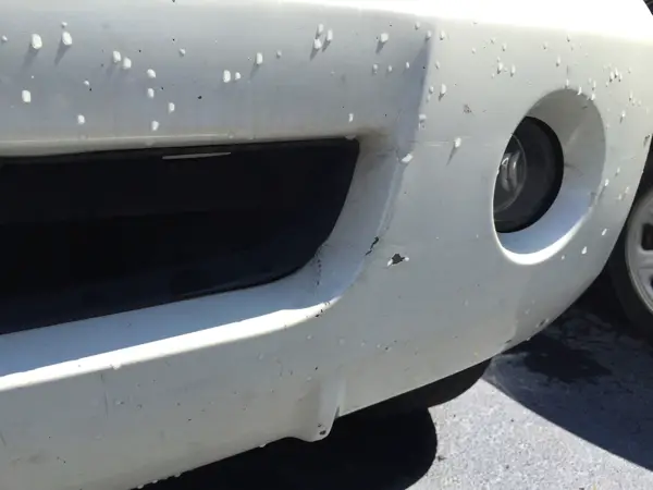

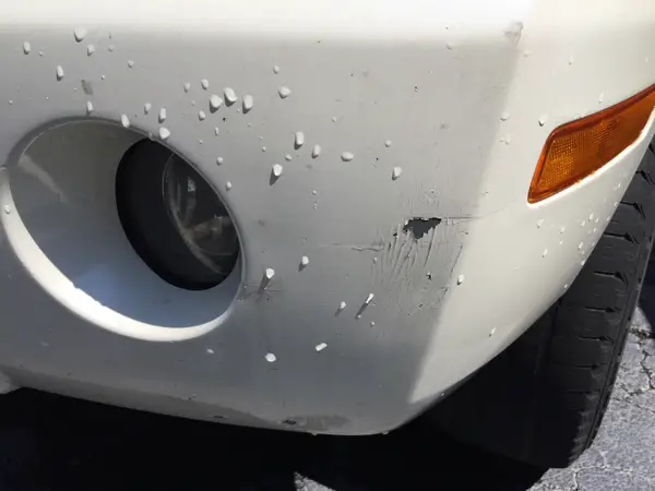

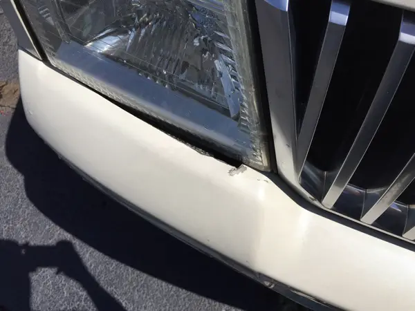

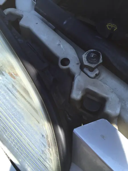

  • a new front bumper and header panel (part grill and headlights mount to.)
  • New hood (just being picky)
  • Both upper control arms (surprise surprise right)
  • New tires soon (it's a used car)

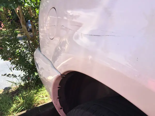

  • Passenger rear was rubbed by something, but no real damage. Just needs buffed and a new reflector.
  • Drivers seat is trashed, I can get this at a wrecker for $45.
  • Passenger mirror glass is busted.

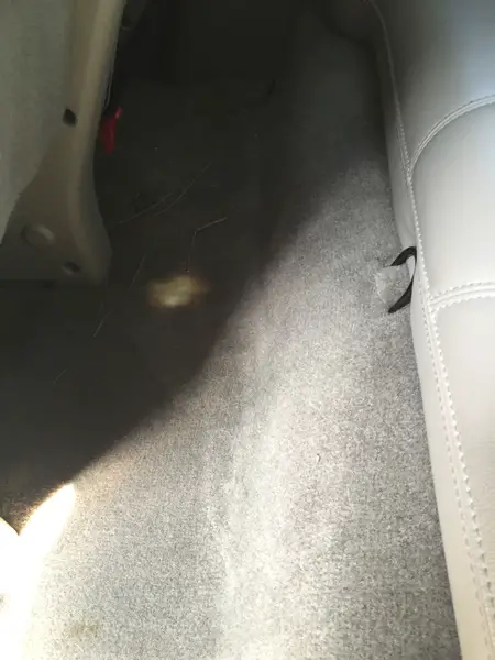

  • Odd stain on carpet in third row. Bleach?

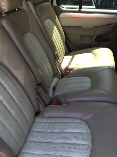

  • Second and third row seats are perfect, front passenger seat needs cleaned.

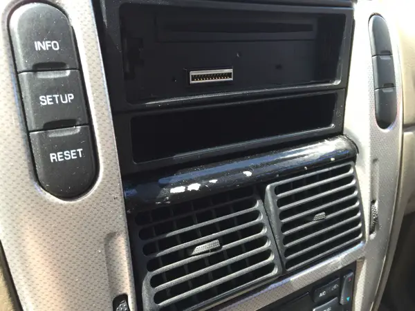

  • Bezel around radio needs replaced ($20)

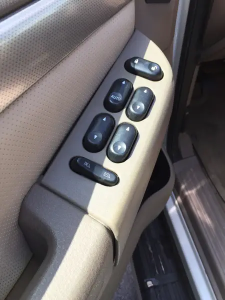

  • Drivers window controls panel isn't seated.
  • All metal in car is clean, undercarriage of car is really clean, no rust on either.

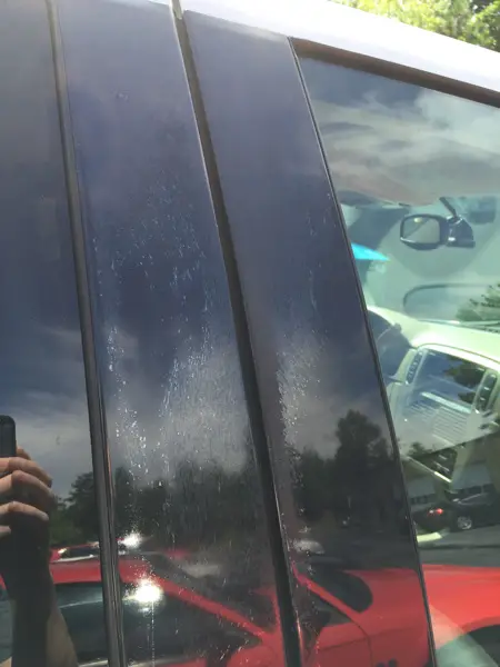

  • Looks like someone used Armor All or something on the interior plastic and some parts have white marks now. Should clean off.

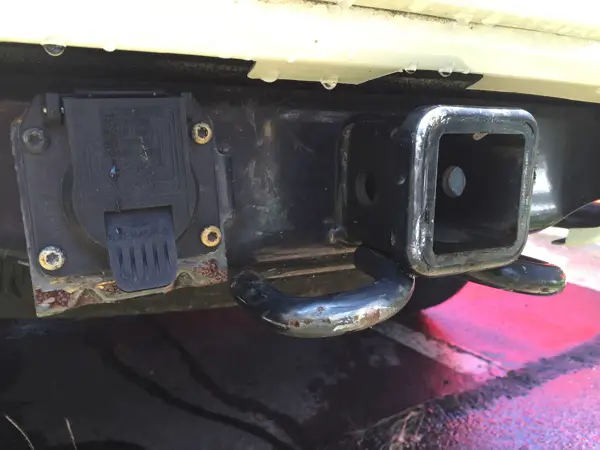

  • Rear hitch has some odd rust, can clean up or just get another.
  • Headlights are yellowed, $40 online each.
  • Needs hood shocks

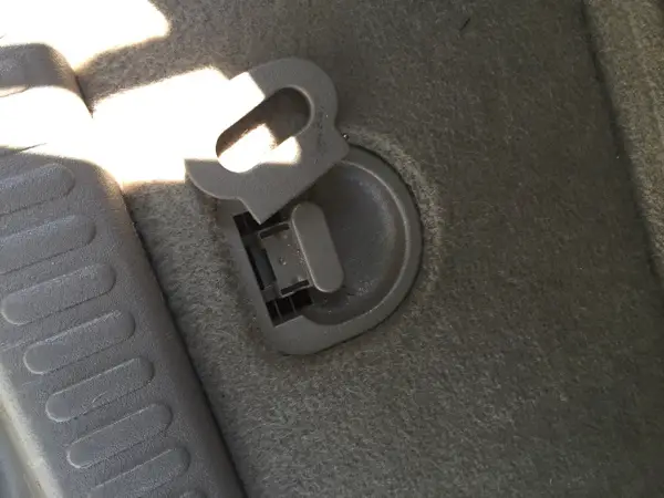

  • Rear storage compartment latch is busted and jack is missing
That's most of the bad. Owner says the trans is good.

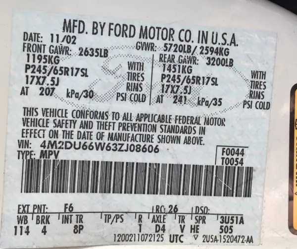

It's worth 450 (D4 axles :-), but is it worth putting that much into a high mileage '03? What would it be worth then I wonder, 3500 or so?

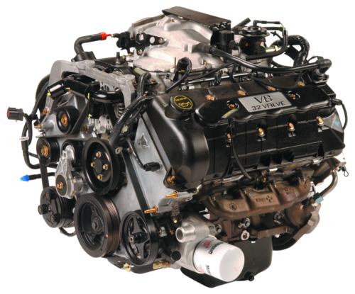

Are those the short block widths? I think the DOHC heads are wider than the SOHC heads.
Below is a 2003 Mach 1 DOHC 4.6L.
And here's a 2002 Mustang SOHC 4.6L.
I suspect that the same is true for the 5.4L DOHC vs SOHC. The engine exhaust manifolds may interfere with the steering configuration. The engine in a 2001 Navigator looks considerably taller than the 4.6L DOHC.
Will you be able to close the stock hood?
