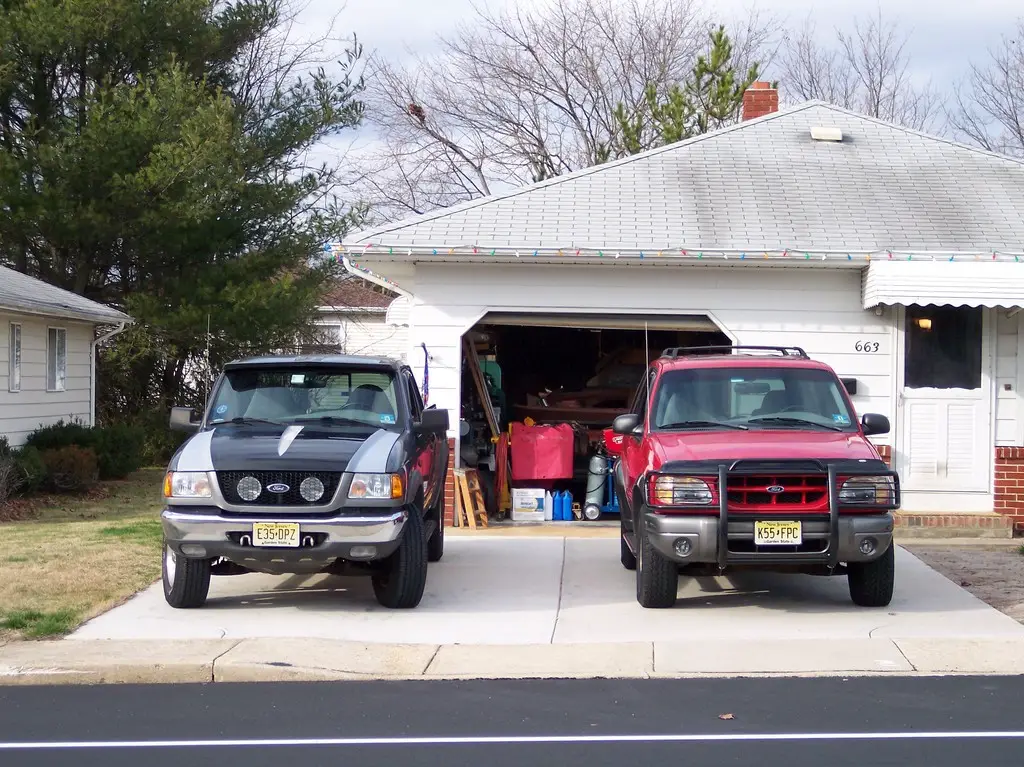

That grill guard looks awesome. Doesn't look to bulbous or bulky like some. Neat!
