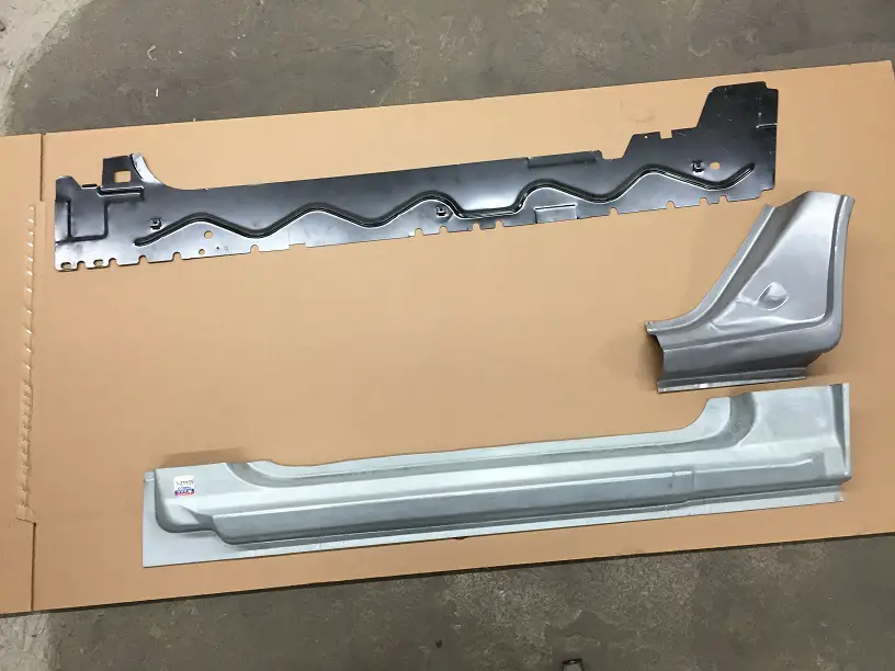

Tabco Panels
Ok - here are the Tabco panels - for those who have done this - are these all needed ? I will probably ask somebody to weld them in (after cleaning the rust out of course) since I don't have welding skills or a welder. Please let me know by indicating top, middle or bottom panel from the Tabco pictures.

But what do guys think ? - Are these Tabco panels the corret replacements - its hard to tell from the picture and I'm probably looking at 200- 300+ with the shipping for these panels.
Any thoughts ?
I don't know about the Tabco panels but thanks for the heads up on them.

Years ago I used a sheet metal break and bent myself a new rocker section similar to the tabco piece on the bottom most location. Obviously my section did not contain the fancy blends on the front and back of the stamping.
I ground out the rust back to clean steel, then primed and painted the newly welded in piece. It looked good for a while, but it only took 2-3 years before I felt like it was back where I started. In hind sight I probably wouldn't attempt this again. And if I did decided to attempt it again I would have done a way more thorough job of removing even more rust. You would basically want to remove 100% of the rust that is withing a 6" radius of the area you are taking pictures of. The reason I say this is because rusting is more formally refered to a Galvanic Corrsion. The chemical process of galvanic corrosion is an electrical process. Meaning that when your body is actively rusting it is creating electric current that is flowing through the steel body.
I appreciate all the advise and recommendations.
Thank you - John

I am planning on getting these for my 99 Sport but I did not see a listing for the inner rocker. Do you have a part number for it?. The drivers side of mine is the worst.
Mike - Tabco sent me those pictures. You can email your pictures to them. Call Dan or Tim at (216) 851-1404. I do not have the part number for the inner rocker. Please also remember that my explorer is a 93 Sport. They were very helpful.
