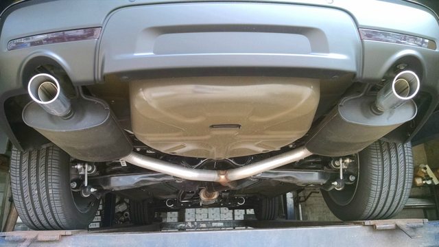

Got the work done a couple weeks ago, and finally getting around to posting the results here. Upgraded my mufflers to FlowMaster 40 Series. No change to the rest of the exhaust system, yet. So far, it was money well spent. It's obviously louder than stock, and there is some noticeable drone noise inside, but not too bad. It has a beautiful growl when the engine first starts.

BEFORE: (completely stock-mufflers)
BEFORE: (completely stock-resonator and cats)
AFTER: (new FlowMaster Mufflers) Sorry for the blurry pic.

Hiya SickSix the exhaust upgrade looks pretty nice and I just had a few questions.
How much did the two muffler installation cost? Were they welded or clamped? Are the exhaust tips stock and re-welded to the new mufflers? Did they weld something to the mufflers so they can use the OEM hangers?

Sorry, I don't remember how much the install was, maybe around $200-300 or so. They are welded on, and the stock tips were cut off the stock mufflers and welded to the Flowmaster mufflers, to keep the look consistent. As far as I know, the hangers are in the same spots on both mufflers, so they were basically plug-n-play.
