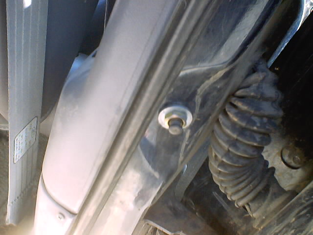

the door sensor may need replacing or the wiring has partially separated from the switch... this happened to mine... i took out switch and placed a washer under it... problem solved... I think when i totalled my truck that it tweaked the body so much that the small travel of the switch always thought the door was open... here is a pic

no the window isn't open. thanks for the replies. what i'll do is push in all the door sensors until i see the door ajar light go off. if that doesn't work it must be the wiring although i have a hard time believing it's the wires.

make sure your headlight switch/dimmer isnt turned to the on position... also, if you pinpoint it, try my washer idea
