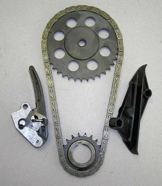

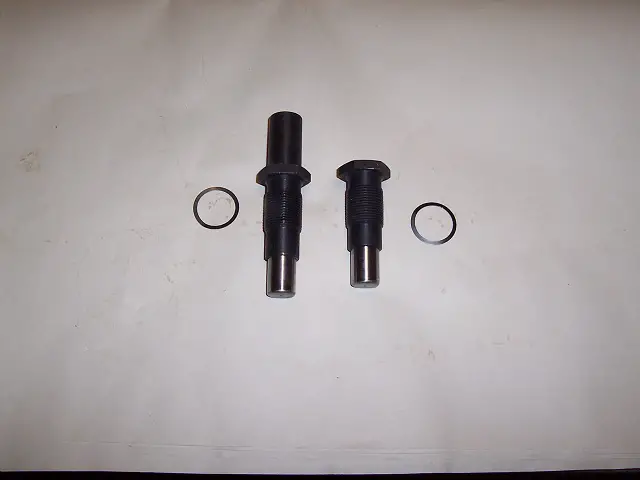

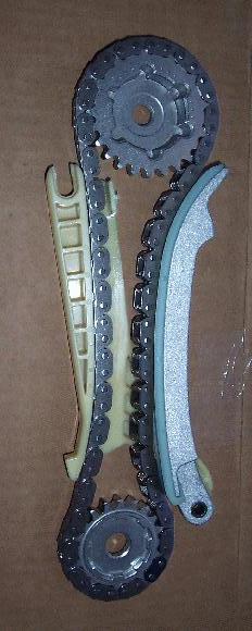

The inferior SOHC V6 camshaft timing design uses a spring/hydraulic piston camshaft chain tensioner.
The longer one is for the front (left) timing chain and the shorter one is for the rear (right) timing chain. A cassette consists of a guide assembly, sprockets and chain. The tensioner presses against the cassette guide on the slack side. The left cassette is shown below.
The right cassette is shown below.

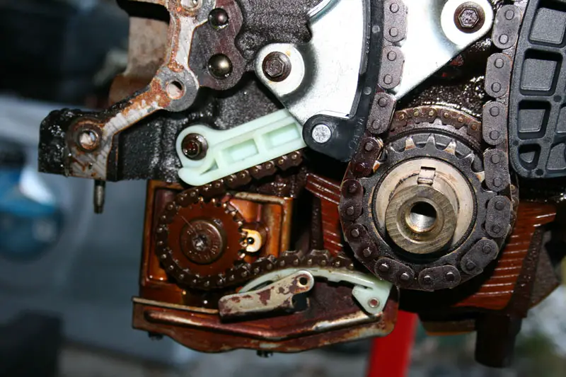

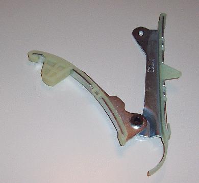

Due to high failures the cassettes were improved during the 2nd generation models and all of the improvements were incorporated in the 2002 and later models. Some parts of the "plastic" guides were reinforced with metal. However, the "finger" on the left guide (shown below) still breaks off.
The traction side of the right cassette was never reinforced and has several failure points.
Unfortunately, the engine or transmission must be removed in order to replace the right cassette.

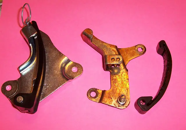

The primary (crankshaft to jackshaft) chain tensioner is a leaf spring type that breaks with age.
The base of the tensioner was enlarged and the number of spring leaves increased from 3 to 6.
The balance shaft chain tensioner is rather frail and fails with age.
The block cradle must be removed to replace the balance shaft chain tensioner because the base mounting bolts are vertical and not accessible with the block cradle in place.

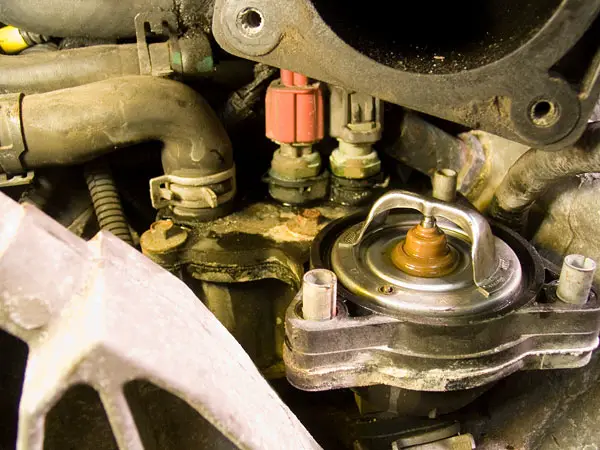

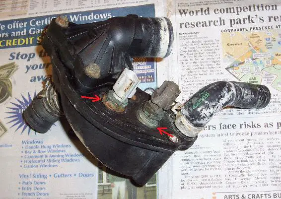

Thermostat housing & cracked head
The thermostat housing is the second reliability issue with the SOHC V6. The housing is made of composite ("plastic" type) material that cracks with age.
Additionally, on the 2nd generation engines the two sensors (engine coolant temperature sensor for the PCM & temperature sender for the instrument cluster) screw into threaded bushings in the housing. Often when the sensor are replaced the bushing comes loose from the housing and leaks.
On the 3rd generation and later models the sensors are retained to the bushing inserts with clips reducing the chance of leakage when the sensors are replaced.
