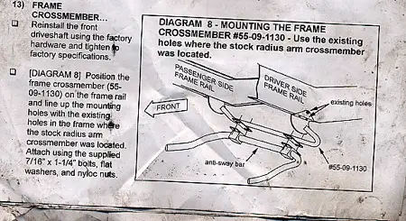

Thanks Digger, it finally came up for me. Here's the page and picture from my instruciotns that is confusing me.
Superlift's believes some Explorers have the sway bar in the rear of the front axle, instead of in front of the front axle.
