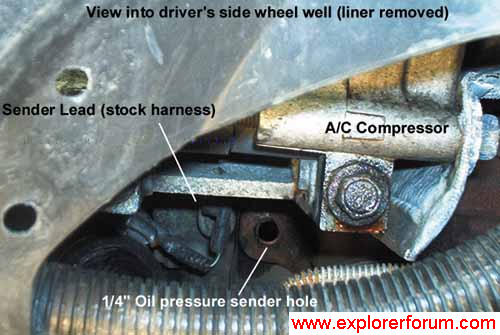

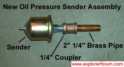

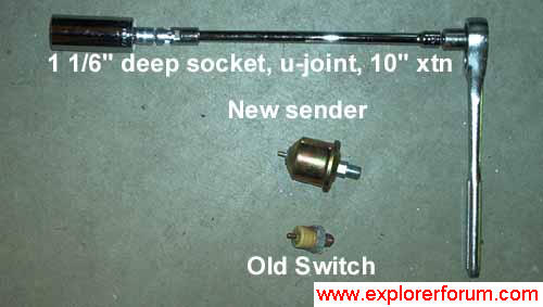

I'm a firm believer in knowing what my engine is doing. I think you can never have too many gauges either. (Turning my Mountaineer's dash into an airplane's dash would be A-OK) But the gauges must work for them to be usefull. The stock oil pressure gauge in stock form is nothing more and an idiot light - it points sky high as long as there is about 5psi oil pressure. It reads low if there is anything less. However, there is a cheap, but time consuming fix.
Many members have posted how to convert the stock guage into a real oil pressure gauge, which shows fluctuating pressure. (Normal - and vital to undertanding the health of the engine) All of these posts have been for the OHV V6. I found that the V8 is slightly different - and a more time consuming install compared to what other members have reported. Parts: 1) Neihoff F133 Sender, From a 1987 F150 5.0. $5.99 Autozone 2) 1/4" Brass coupler $0.39 Home Depot 3) 2" 1/4" Brass pipe, $1.00 Home Depot 4) Teflon Tape 5) RTV sealant 6) short length of wire, 2 butt splices and heatshirnk tubing 7) 1qt ATF (for powersteering system) 8) PB blaster for stuck/rusty bolts Special Tools needed: 1) 1 1/6" DEEP DRIVE socket 2) 10" extension 3) U-joint for socket Once all of the tools and parts are gathered, give yourself a full day to get this job done. It may help to have an extra vehicle nearby to run for parts. This is the method I chose to install the sender. There may be a better method, that involves less cuts and scrapes. Be carefull when working on your truck, but have fun and be creative Part One: In the Engine Bay 1) Remove wheel well liner 2) Remove the reservoir-P/S cooler power steering hose from the small cooler. Drain the P/S reservoir. 3) Remove the battery 4) Unbolt the battery tray, (3 13mm Bolts) and disconnect any hoses/wires from the battery tray. 5) Remove the 10mm nut holding the powersteering hoses to the side of the A/C compressor. Route high pressure P/S hose out of the way. Disconnect low pressure hose from reservoir, and pull out of truck. 6) Disconnect green electrical wire from current oil pressure switch 7) Use 1 1/6" deep drive socket, u-joint and extension to remove the oil pressure switch ![]() 8) grab lunch - you're halfway there. 9) Assemble new oil pressure sending assembly. Use one layer of teflon tape on all threaded joints, as well as a THIN layer of RTV sealant. You don't want it to leak, but the electrical ground travels through the brass pipe. Make sure everything is tight. ![]() 10) Insert assembly into block hole. It may help to have a partner guide you by looking into the wheel well, while you stick you hand down the hood. ![]() 11) Use a 9/16" wrench on the base of the sender to tighten up the works. This process really requires patients and contortions. You will get scraped hands from the fanblade, but hey, no pain, no gain. 12) The old electrical wire is too short. Remove it from the block by undoing the two clips behind the upper serpentine idler pully. They just pull right off. 13) Crimp/Heatshirnk about 24" of 18 ga wire into the current harness. you want to keep the stock plug at the end. Rather than running down the front of the block, i chose to run down the side of the A/C compressor with the new wire. 14) Reassemble everything 15) Refill Powersteering system 16) Start the X up, check for leaks in both the oil and P/S stystems. Part Two: Behind the Dash The dash was removed as part of a mult-day project of replacing the stereo system and wiring in some Aux lights. Dash removal instructions by bigtigexplorer were followed. http://www.explorerforum.com/forums/...threadid=37017 Once the dash was out, I replace all of the 194 lightbulbs used for illumination. Setbacks... Setbacks... what was supposed to be a ten minute solder job... wasn't. On early model Explorers and Mustangs, to make the gauge fully functional, a 20 ohm resistor needs to be bridged on the back of the dash. However, my dash did not have this resistor. In mid 96, Ford stopped putting in real gauge armatures in Mustangs since they weren't putting in senders. It appears they did the same in my Mountaineer. So I'm stuck. There are several options. 1) Do some hardcore electrical engineering to get my gauge working. 2) Tap into the sender, and run an external gauge, and leave the dash alone. 3) Go junkyard diving and get a 95-96 gauge cluster. Many thanks to Maniak for helping me troubleshoot this problem. The diagnostics are taking place in the following thread: http://www.explorerforum.com/forums/...&postid=601393 Notes: I know some people have asked about the resistance values of the Neihoff Sending unit. I hooked it up to my air compressor before installing it on the truck. 0 psi = infinite ohms 20psi = 30.7 ohms 30psi = 28.5 ohms 40psi = 24.4 ohms 50psi = 21.3 ohms 60psi = 18.9 ohms 70psi = 17.1 ohms The original ford unit is: 0 psi = infinite ohms 6 psi = zero ohms This is a writeup of the mod on a mustang: http://www.fuller.des-moines.ia.us/p...obra/oilgauge/ EDIT: December 2003 I have replaced the 6psi switch, and installed an Autometer Oil Pressure Gauge. For the writeup, go to page two

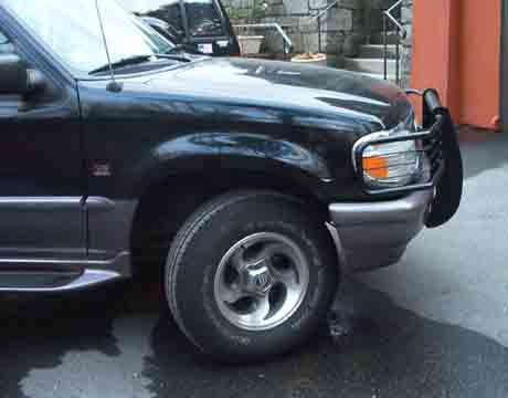

Brushgaurd
I really like the looks of brushguards on SUVs, an even though many on the road today are all show and no go, and on the front ends of grocery getters, I decided to get a guard for myself. When researching, I was dismayed at the extreme cost of such guards by Manik, WAAG and Smittybuilt. Manik has an online outlet where a nice 1 piece, frame mounted guard could be had for close to $300 - and it needed to be repainted. I called local junkyards. No luck. But - while thumbing through the JC Whitney catalogue I found what looked like a perfect solution. For only $125, a decent looking brushguard. Yes it was bumper-mount, yes it was knockdown, but it was in my budget. When it arrived at the house - I was unsure. That was a small box! But put together it fit the front of the Mountaineer quite well. The wrinkle finnish looks durable, time will tell. The only defect was the passenger side light mount was welded on slightly crooked. Once the center section was assembled, I marked the top holes on the bumper, drilled, and then bolted the gaurd on. Don't drill the bottom holes untill the top bolts are torqued down, the plastic bumper cover compresses about a 1/2." After the top 2 bolts were secure, I drilled and bolted the bottom two bolts. The side wings were bolted to the center section. Install time took less than an hour, including assembly of the center section and aligning it. Hella 500 Driving Lights Simply bolted to the light mount tabs on the brushgaurd - it couldn't have been easier. ![]() Brushgaurd and Lights, Front View ![]() Brushgaurd, Side View __________________ -Aaron !!!!GO RED SOX!!!! Off Road: 97' Mountaineer: V8, 4x4, 4.56s, 4" Superlift, SOA, TrXus 33x12.5 - Under The Knife Work: 00' Ranger 4cyl 5spd On Road: 2006 VW Jetta TDI/6spd DSG. Fill it with diesel, please. Octopus Yachts, LLC Engineered Marine Electrical Systems

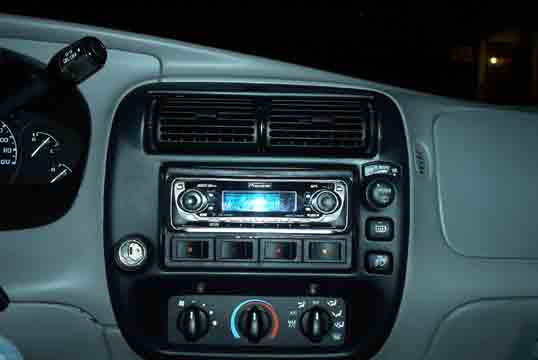

Yes. Spring break is here, and the Stereo install has begun.
The truck came with the Audiophile JBL system, which sounded great, but I needed to upgrade. Unfortunatley, the "dstributed architecture" made this install more challenging, as I chose to rewire the entire vehicle. This is my fourth major custom car audio install. Pioneer DEH-P7400MP ![]() Head Unit Installed along with switches for onboard lights Pioneer 12 Disc Changer ![]() Subwoofers and Amp ![]() Rewiring the door speakers Since the JBL system pretty much necessitates rewiring the entire vehicle, new 16ga speaker cable needs to be run to the doors, through the rubber booties. What makes it challenging is the S curve of the booties, as well as their corrogated constrcution. The best wire fish is a heavy duty wire tie, starting in the truck, and fishing into the door. It makes a word of difference to pop the rubber out of the vehicle and/or door and try to strighten the bends out. The Drivers door presents a challenge. Instead of the rubber going from a hole in the body to the door, there is a bulkhead connector. This is probubly due to the LARGE number of wires in the junction. It allows quick seperation of the door from the body. 1) Disconnect the lower connector by loosening the 10mm bolt. 2) Notice the two small holes on the door under the bulkhead connector - thread the speaker wire through here. 3) Run the wire through the rubber bootie, using the cable tie fish method 4) Re-attach the bulkhead connector, trim off the excess speaker wire. Antenna Wire The truck comes with the power antenna. Since the reciver is in the rear quater panel, the antenna wire runs throug the passenger side wire chase to the unit. Fortunatley, in the passenger foot well, there is a junction for the antenna lead. I used the lead as a wire fish to run the cables for my new 12disc changer. The connector on the antenna is NOT a standard radio connector, an adapter ($10) is needed, as well as a 4ft Antenna extension lead. The Power Antenna needs a relay control to go up/down. Simply wiring it into ground and the remote turn on lead will force the antenna up and burn out the motor. I've always wanted manual control of the antenna, so it can be down while listening to CDs. The control was accomplished by using a momentery on-off-on switch and relays. write up and diagram to follow This Post will evolve as I have time to write it up __________________ -Aaron !!!!GO RED SOX!!!! Off Road: 97' Mountaineer: V8, 4x4, 4.56s, 4" Superlift, SOA, TrXus 33x12.5 - Under The Knife Work: 00' Ranger 4cyl 5spd On Road: 2006 VW Jetta TDI/6spd DSG. Fill it with diesel, please. Octopus Yachts, LLC Engineered Marine Electrical Systems
