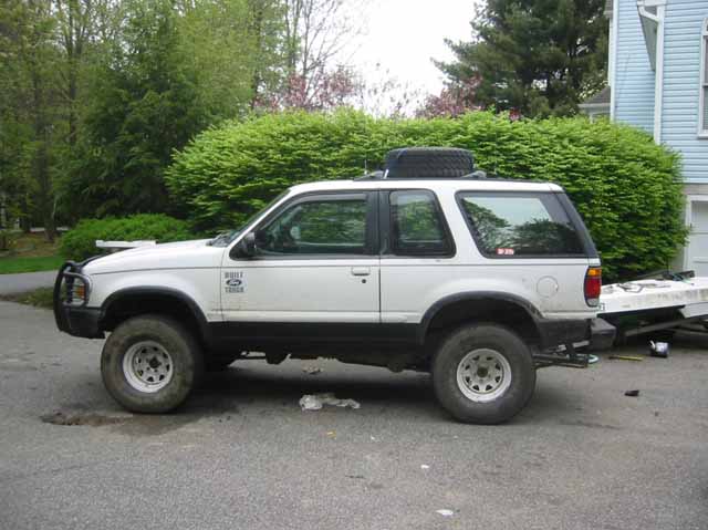

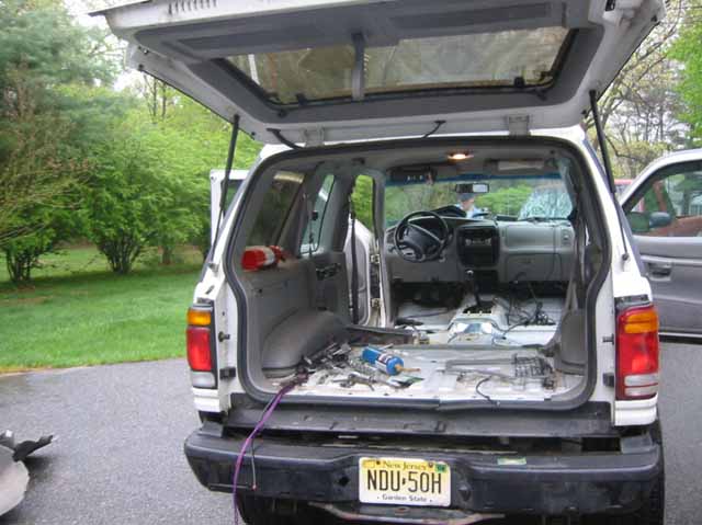

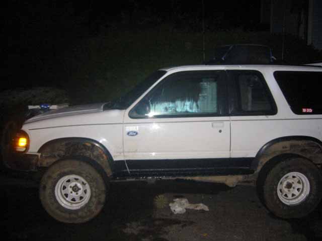

You should all be happy to know i herculined my truck and kept it off my hootus. (sorry gerald :D) I pulled out the carpet and herculined the floor of the explorer and i herculined the rockers up to the molding on the doors. and here are the pics..

last one, I dont have any pics of it with the seats in ill have to take some tomorrow. It's not nearly as loud on the highway as i thought it would be.

Will herculiner cover the holes left in your rocker panels after the factory running boards are removed?Just wondering if it was thick enough.I want to take mine off and needed to find something to cover them up.
nope the holes are still there. It's not thick enough to cover them up.
lol, it looks like somebody stole your truck and gutted it in the first pic...
If those hole are the same size as the ones used to mount the tupperware, then go to the local hardware store and 5/16" nylon grommets and plug them with those. Makes it look like rivets under the herculiner. That's what I used to fill up mine when I herculined my rockers.

seats are held in with 5 bolts. i just left the wires under the seats alone since thet dont get in the way. there is a wire bundle that runs along the feet of the rear passengers that i still have to cover up so it doesnt get damaged. you can see it a little bit in the 2nd picture.
