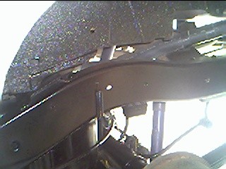

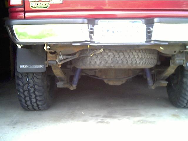

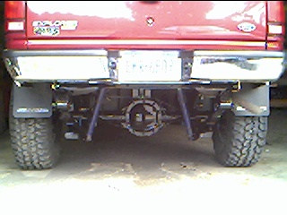

heres the before.

Looks awsome. What did you use to get it soo smooooth?

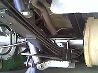

i spent hours underneath. i used a putty knife to scrape the road tar (i think thats what it was) then i wire brushed most of it to bare metal and some sandpaper. then i wiped it all down real good with paint thinner. then i primered it. i went to local paint store and he recomended an acrylic paint, so i had him mix me up a couple of cans at 13bucks a can. i was really impressed with it. i did the outside frame rails to they turned out just as nice but i couldnt get a good pic to show it. here ill post it anyway.

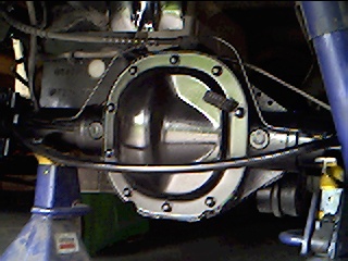

wow.. that is awesome.. looks brand new, did you take the diffy cover off to do that, or just do it with it on? and did you use a thin or thick brush? wide or narrow?
i left it on. and it was all done with spray cans.

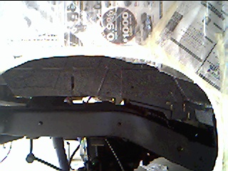

i took the rear bumper off, both tires and taped the back end up. then cover the whole truck with plastic drop cloths 3 of them for 99cents each. i deleted most pics of it taped up but i scrounged this one.
