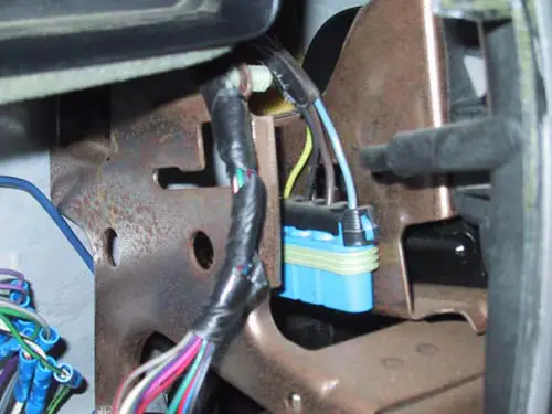

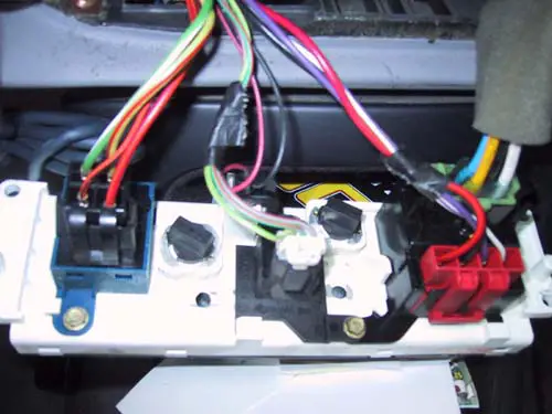

I already looked into it....i got one at the junkyard a month ago, and yes, you will need 3 sensors....a sunload sensor located i think in the engine compartment, but i believe it is in the dash? An ambient air temp. sensor located by the radiator cap on a 4.0 sohc...and an in-cab sensor located in the dash...i think by the radio on the driver's side...must pull dash insert out though...
it is not a plug and play...there are more wires to it....2 wire harnesses...but the only thing that is plug and play is the air hoses...there a five of them...a blue, yellow, black, red, and green....you already have these....
I think it would be no problem if you have a short base console... you just cant operate a rear blower motor since you dont have one... otherwise, i do advise everyone to get a cd rom servise manual...it will tell you what wires go to what...
and NOTE: some digital hvacs have differnt wire colors...
i got a 98...i got my digital hvac out of a 95, the wires did not match...but i believe it would perform the same function...just different wire color...
