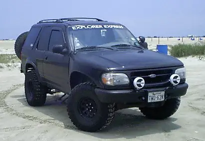

Yes, I am now sponsored by EE:

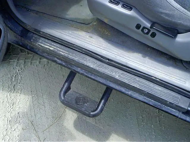

step and removed trim.

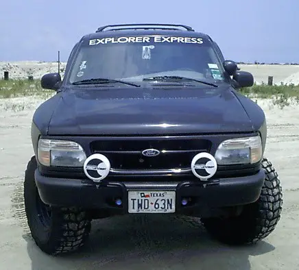

Explorer X

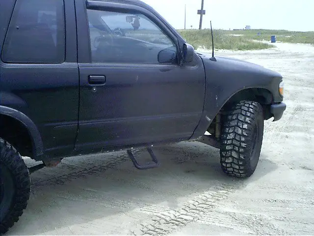

passenger side

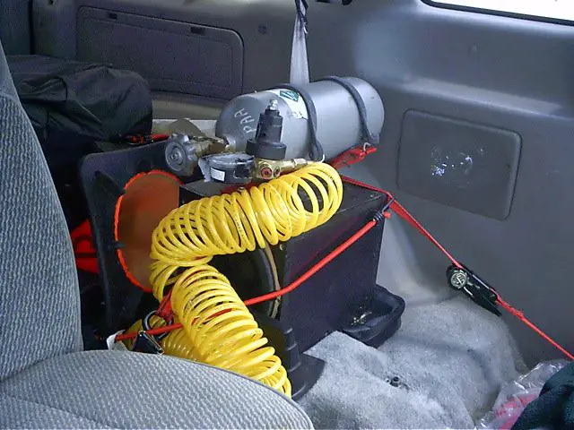

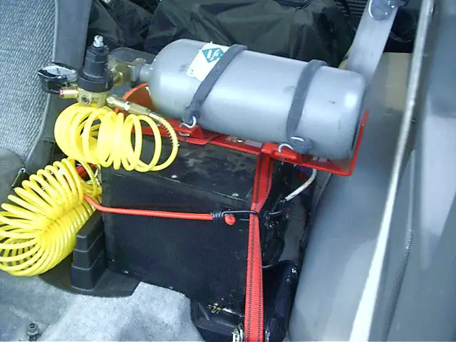

bad pic of removed seat and the sub box strapped down.

Damn Alec Bungie Heaven. How many fills do you get out of the bottle? Is it Nitogen or Compressed Air? Looks tough.
5 lbs of CO2. I get about 6 33x12.50 tires from 10 to 35 psi.
Is there an advantage to using CO2 as opposed to the later. Beside it would double as a cool extinguisher.
Compressed air doesn't give as much bang-for-tank size. Nitrogen is very good to use, but it's more expensive.
Since I got the 33s the tank is a bit small, but I usually only do single or 2 day trips where I don't need to air up in the middle so it works. If I go on a longer trip I can use the tank to bring the tires up to around 20-25 psi so I can travel on the road safely until I have a chance to fully air up.

Hey Alec, I work with compressed gas alot and you should have that Co2 mounted upright. If you have your truck on a slope you might just be drawling liquid Co2 into your regulator (not good). Co2 is the only gas that you have to worry about doing this since it is in liquid form in the cylinder.
Even if the bottle is tightly closed? I'm careful to always bleed excess CO2 through the regulator after closing the bottle when I'm done using it.
