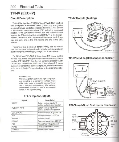

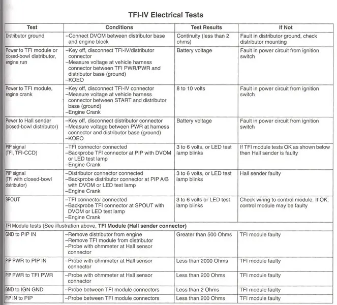

I was going to post these yesterday morning, but my cable connection was down. You may still want to test the ICM with a ohmmeter to verify that it is ok.
tfi second page
