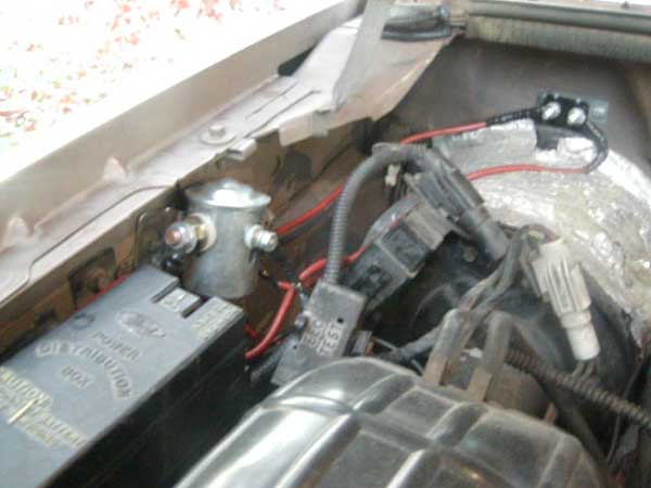

Here is all you really need....Mine is just hoooked up with 10 guage wire, as I was just using it to charge a battery while pulling a travel tralier. If you need, large guage can be used....

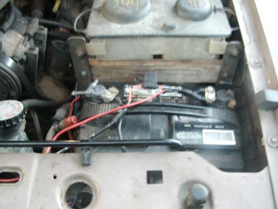

The second battery....

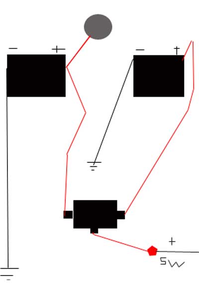

Ok.....here is my visual attempt at explaining it.....Sorry for the drawing...best I could do
The cable from the round thing is the POS cable from the alt/starter etc....., to the stock battery.
The neg lead that goes out from that battery is the stock neg cable.....
The lead that goes into the solenoid carries the charging power to the second battery...when the middle (small) terminal on the solenoid recieves +12V...the solenoid turns on.....so the second battery is connected to the first.....
The Pentagon thing is the switched power source....all you have to do is find a hot source that is live when the truck is started...like the wiper circuit....
