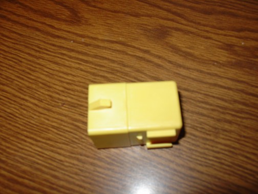

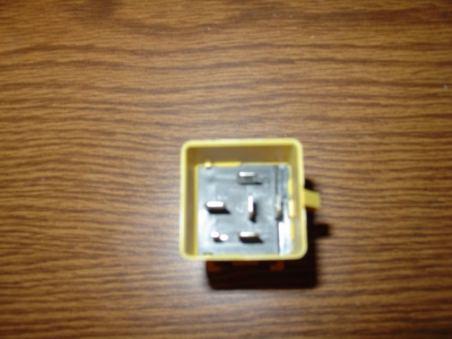

Quote:
Originally Posted by Eneurb
It is a yellow relay right under the steering column.
That is correct.
However, its not as easy to get to as it should be. First you have to remove the plastic lower dash cover and then remove the metal dash cover to access the are in which the flasher is located.
This is not a simple flasher, Ford, intheir infinite wisdom decided to use an electronic flasher that not only controls the turn signals but also the hazzard f lights.
The real pinch is the price of the electronic flasjer. Ford part number F67Z13350AA is $34.75 plus tax.
