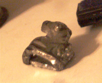

WOO HOO I FOUND IT!!!!!!!!!
Well i feel stupid. i disconnected the e-break cable a while back and a piece of the mechinism that is behind the rear rotor dust cover came loose and was bouncing around in the cubby hole on the passenger side rear tire. ha ha, whew had me freaking going nuts for 2 days lol. here is the sh@tting thing!

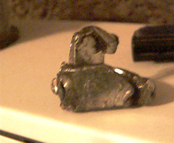

another

Wow! Good find. Sure beats pulling the tranny. I was thinking if it was rattling around in there or the t/c you could have been in for some $$$ repairs.
