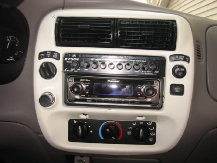

what kind of dash kit are you talking about?
i don't think they make one that will fit two 1 din sized items. you'll probably have to do a little trimming of the bezel as well. Its not big deal though.
here is a picture of a truck with a 1 din and a 1/2 din (thanks to mike knott- his truck)
