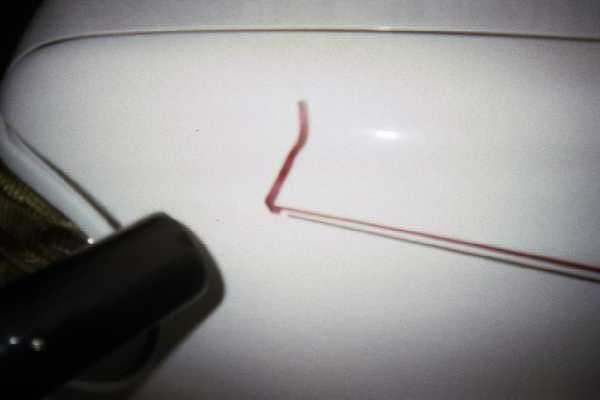

removed the pinstripe... I finially got off my lazy arse to write this thing up. Excuse the darkness of the pictures, for some reason when CVS put the pics on a disk they turned them really dark. I figured I'd do a small writeup incase anyone was interested.
Weapons of choice:
Hairdryer
Fingernails
Extension cord
Alrighty, on a nice warm day...
start off by heating up the stripe and then using your fingernails to get the start of it off.
to remove I just kept pulling, heating the pinstripe that was still on the ex. DO NOT OVERHEAT it... this causes it to break often as you're pulling it. I was going ~1-2 in/sec.

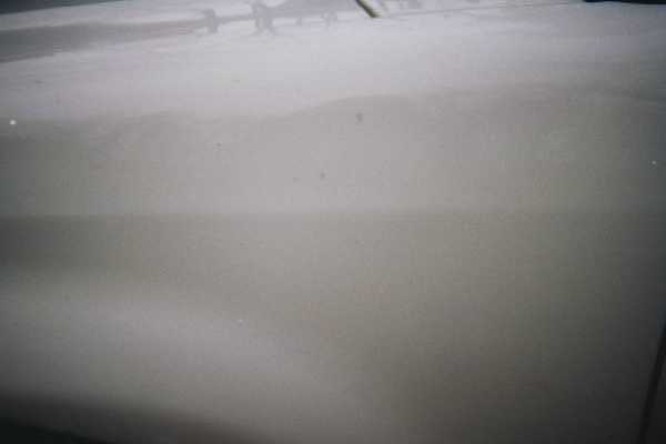

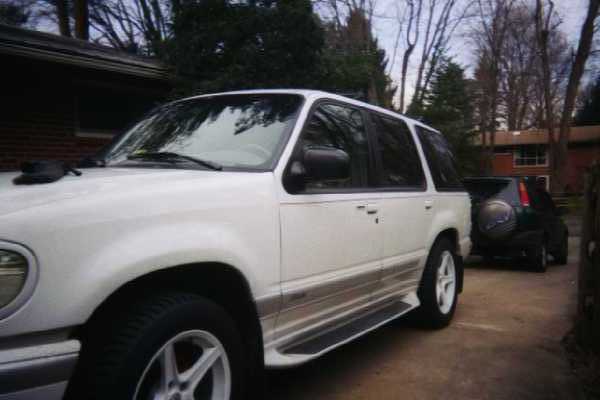

ok enough of this writeup hoopla - here are before/after pics. Whole thing took about 20 minutes.
Here is the ratsnest I was left with when I was done.
Removing the pinstripe revealed a ridge in the bodywork, which I think looks really really really good uncovered. I found a very small dent that had been covered up by the pinstripe, but oh well. I havn't washed the beast since I removed the stripe, so I dont know if the current color differences where the stripe was are permanent . Trim/bumpers are getting painted in about a week when my friend gets back from FL and I can use his garage... so look for pics soon.

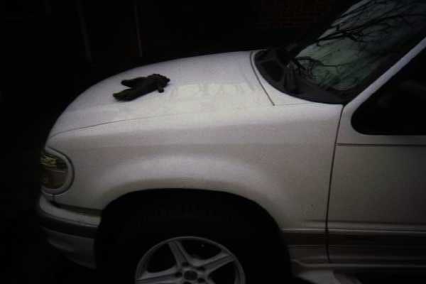

Here are before after pics that were photoshopped...
Here is what it should look like in a week or so...
