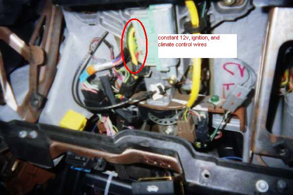

Driver's dash panel off below the steering wheel... before we started messing everything up.
The power wires connected, ignition wire, and climate control wire connected. This was the easy part. Hokie is fiddling around with something probably importatnt.

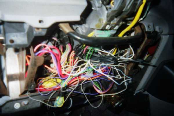

We had a small problem halfway through the install... Had to stuff everything up and drive to bestbuy we thought that the reciever was dead. It ended up that we hadn't grounded a wire (thought we didn't need it). Then it all worked good after that.
This is at the beginning of the install... notice how small the rats nest is.

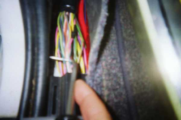

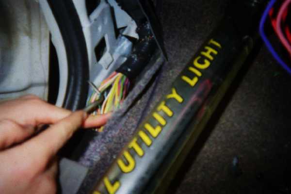

Digging through the huge bundle of wires to find the factory disarm wire (read story above). This was such a pain... Not only were there similar colored wires, there were 2 wires w/ exactly the same color!!! This is after we found the first wire w/ the color we were looking for
One of the wires that looked close to the wires we were looking for.
Here are the two wires that look exactly the same... Hard to make them out, but trust me there are two.
Holding out both the wires again...

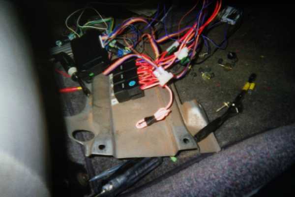

Finishing up... relays mounted to the metal plate that is behind driver's side dash panel
Almost done...
