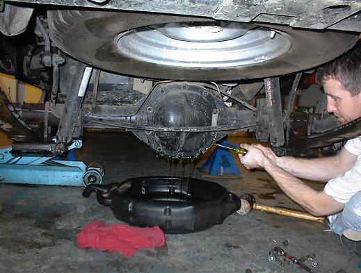

Open the cover up and get the old oil out. The gasket sealer kept it on there kinda tight after the bolts were out. We pried on it with a flathead screwdriver a little at a time till it finally gave up it`s lifeblood to drain into our catch-pan.
To make it a little easier, we undid the sway-bar, so we could move it out of our faces. (Carson refused to get rid of that thing altogether, we gotta talk him into it)

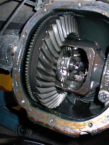

Once you got all the oil out, you undo the pinion shaft lock bolt, then take the pinion shaft out. If you rotate the axle, two of the gears will fall right out for you, they are held in by the pinion shaft. The two on the ends of the axle shafts can be pulled out after removing the C-clips.
Make sure you get the thrust washers out that are behind the shaft end gears, these need to be re-used, along with the pinion shaft, and the pinion shaft lock bolt.

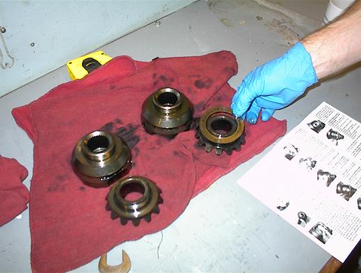

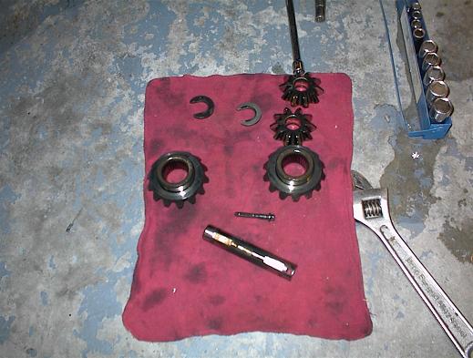

You will end up with these parts sitting there, the thrust washers are still on the shaft gears, if yer wondering:

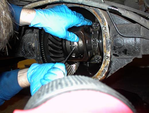

Next, you put an outside part of the clutch mechanism on the ring gear side of the axle, push the axle back in nice and gentle so you don`t mess up any seals, put the part on the end, and push the C-clip back in place. Use a liberal coating of gear oil and it should slip on easily, remember the O-ring goes on the tire side of the axle, It`s a snug fit.
The two halves of the locker are identical, so it doesn`t matter what side you use, make sure to put the thrust washer on the end of it though, you`ll know what end.
After this pic was taken, I pulled back sharply on the axle, to ensure that the clip is seated well, and it gets it out of the way and into it`s proper position:

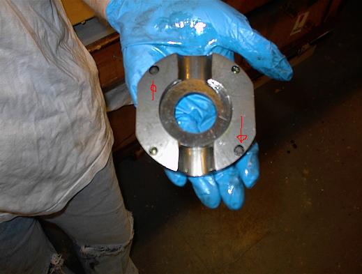

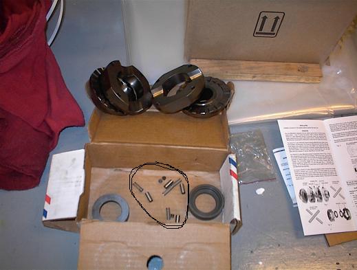

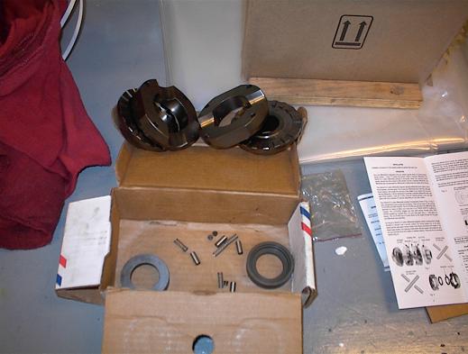

Next, you have to put the next parts on that side, the other part of the clutch with two dowels in the ELONGATED holes, and the spacer, which fits over the end of the C-clip, inside the clutch half. You can take the time now to put the end caps on the springs if you want. DON`T LOSE ANYTHING, or yer in trouble.
The dowels, springs and end caps can be seen circled in the pic, you can also see the spacers, they fit on only one way, with the larger opening towards the axles, covering the C-clips:

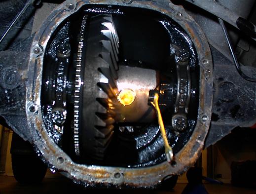

Here`s the tricky part. You have to get the second C-clip in with all the the locker components in place. The ring gear side will just be sitting there on the end of the shaft, and you will have to hold the other clutch part in place with the gap in the teeth showing. You then have to get the shaft to the proper position so that you can slip the C-clip on.
Remember to have the dowels in place, there is two on each side remember, and coat that C-clip in gear oil so it slips on nice. AND that O-ring has to be on the tire side of the shaft remember. Don`t worry, it is quite easy.
I used my pick to push the C-clip in.
Then, you pull back sharply on the axle shaft to ensure it is seated correctly.

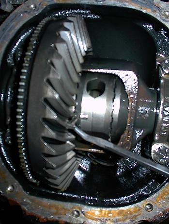

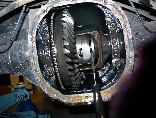

What you do now is use a pick to push the dowels into the adjacent clutch, opening up the holes again for the installation of the springs.
The pic is kind of blurry, but you can see I`m about to push a dowel over with my pick:
