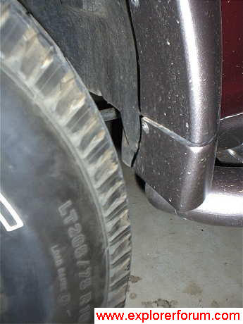

I had to do very minor trimming which is shown in picture 2:
When out romping through the desert, the inside top of the wheel wells were shiney so the tires probably touched them when at full compression but not enough to worry about. On the street they never touch. Fortunately you already have the 4.10 axle. With the larger tires, the power loss feels about the same as turning on your A/C. Your speedometer will be about 4-5 MPH off at 65 MPH but I fixed that with an $8.00 speedometer gear from Ford. The tires look and ride great. Discount Tires had no problem putting them on for me. They even test fit one the day before to be sure they would fit. The rear tires are no problem at all.

I just purchased a set of 4 BFG AT K/O 265 75 R16's Saturday, I had the same problem that Robert was having, (some rubbing on the lower front wheel well moulding). Today at Lunch time I took the plastic molded parts off and cut them so that there is no more rubbing, Now all is Good! Let me tell you, the BFG AT K/O 265 75 R16's Really make a Stock Explorer Look Mean!

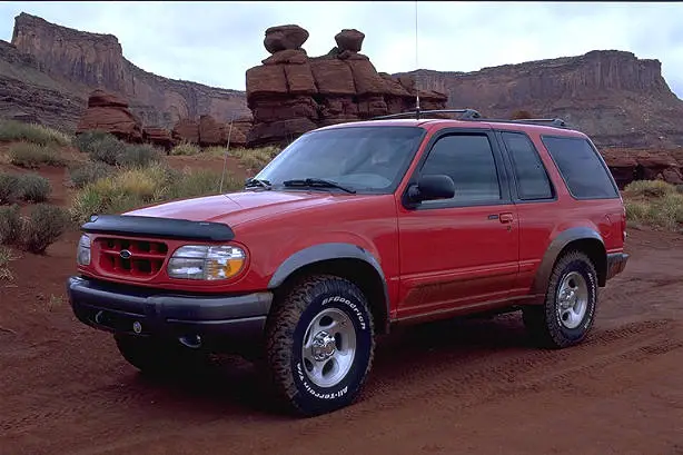

I did exactly what Robert did; I put the BFG 265/75-R16's on my sport and had to trim the same spot. I've had no rubbing, even off road and I know that I had the springs at full compression as evidenced by the clean marks that the rubber stops left on the control arms. Unfortunately, I don't have a close-up picture of my trim job, but it is the same as Robert's.
Here's a shot of the truck at moab:
Note that I removed the step bars for added clearance.
Also note that this photo was taken before the new OME rear springs. Picture about 2" more clearance above the rear tires. :)
