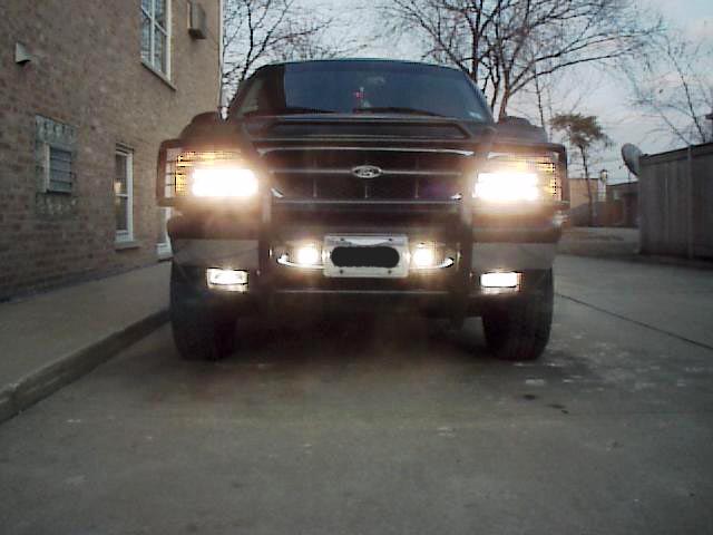

Here's my 98, it has the 1552's in the stock location, and the 1450's in the air slot next to the license plate.
looks *****in! :)
Thanks Matt, I appreciate the compliment, especially from the "Lord of Light". :cool:
I really don't know what the differences are. Mattadams is the PIAA guru, he may know. I did a little searching, and couldn't find any info about the XT's. Sorry.
1552 is the model number, 1500 is the line number if that makes any sense. 1552 is just the clear driving version of the 1500. For more details go here:
