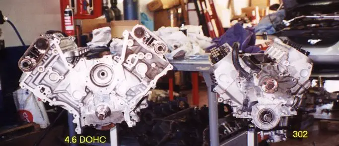

a 5 liter (302) is a somewhat tight fit in an explorer. with that said, look at this comparison.
wow, that cleared things up. why would the 4.6 be so much bigger than the 5.0? i can see it has more cams and overhead but the block seems so much larger.
wow, I was wondering the same thing, how about a 4.9?:rolleyes: I think the nose may need to be stretched for that one
If you notice on the Modular (4.6) the valve covers are the huge part of the engine. Imagine the heads being taken off and you will see that the block is just about the same size. The 4.6 in the F-150 is a 2V motor, so it won't be astronomically large like that 4V 4.6 in the picture. It MAY fit, but it probably wouldn't be worth it really unless you put some FI to it :D

The I-6 is an AWESOME work truck engine, because it makes its peak torque of 270 lbs/ft BELOW 2,000 RPMs, but it makes about 150 horsepower so it's a poor speed engine. In engines, displacement isn't always the most important factor when comparing external dimensions. The Chevy LS1 Gen III smallblock is 5.7 Liter, but is dimensionally SMALLER than the 4.6 Modular because the modular has those big bulk cams on top of it.
Majisto, the SOHC 4.6 isnt alot smaller than the DOHC. i cant remember exact width measurements, but the DOHC isnt really that much bigger. if i had a side-by-side shot of the SOHC, i would post it. :D
